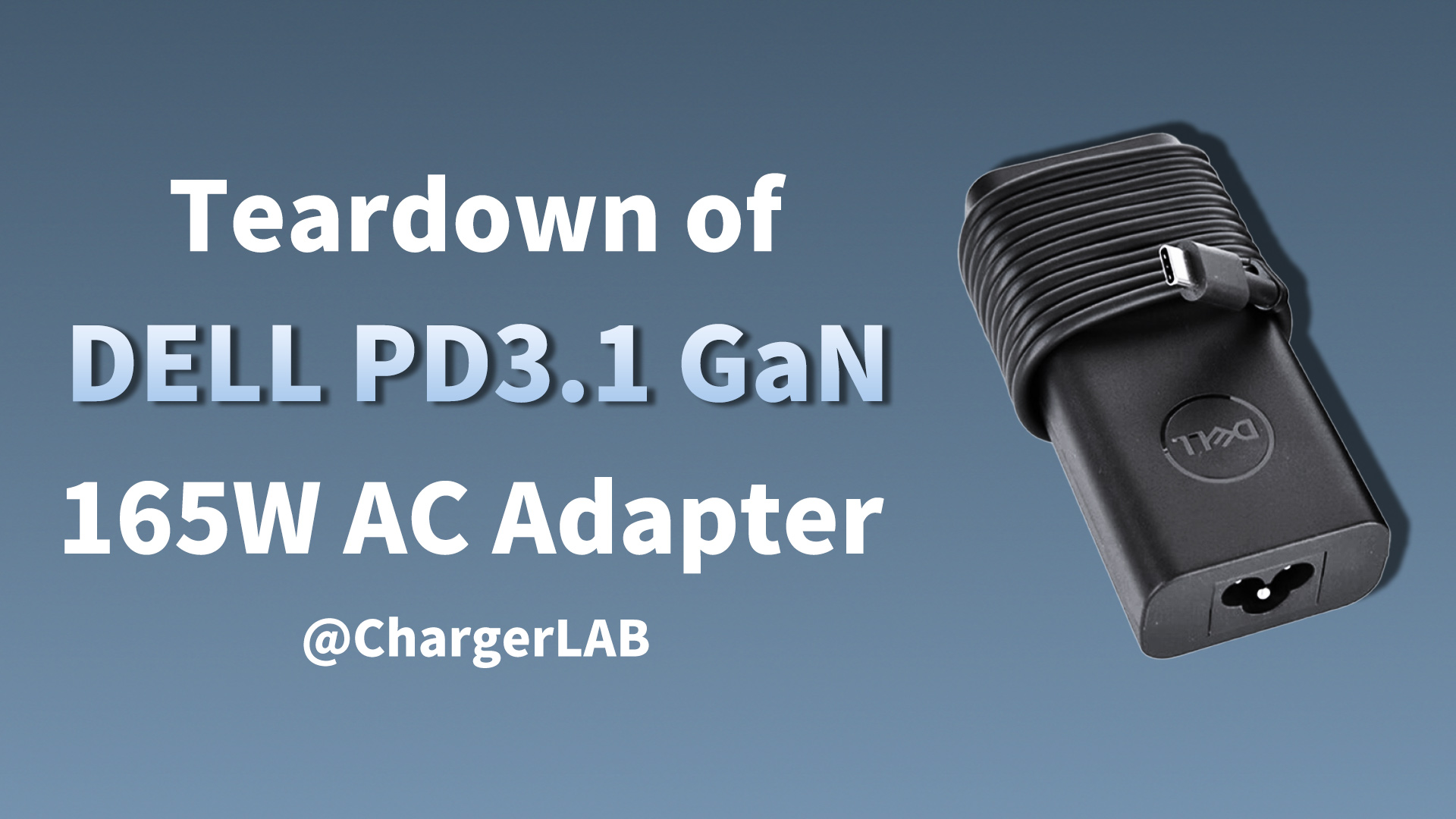

Support PD3.1 | Teardown of DELL Original 165W GaN Laptop Power Adapter
December 22, 2023
Not long ago, ChargerLAB took apart several USB-C GaN chargers from DELL, which only support PD3.0. This is the first time for us to get a DELL 165W GaN power adapter that supports PD3.1.
And we are going to take it apart to see what the internal components look like after supporting PD3.1.
Model: LA165PM210
Manufacturer: LITEON
Fuse: WalterFuse
Safety X2 Capacitor: HJC
Active Rectifier: LITEON S8MC
Active Bridge Rectifier Controller: NXP TEA2206
Rectifier: APEC AP60SC125DDT8
PFC Circuit:
PFC Controller: NXP TEA19162
PFC MOSFET: Infineon IGLD60R070D1
PFC Rectifier: Yangjie MURSL860D
Electrolytic Capacitor: SAMXON
Bypass Diode: LITEON S8MC
Primary Circuit:
Master Control Chip: Infineon LTA2102
Half-bridge MOSFET: APEC AP60SC200DDT8
Electrolytic Capacitor: Elite
SMD Y Capacitor: Holy Stone
Optocoupler: LTV1007, LTV1008
Secondary Circuit:
Synchronous Rectifier Controller: MPS MP6951
Synchronous Rectifier: Infineon BSC0802LS
Solid Capacitor: SAMXON UER series
Protocol Chip: Weltrend WT6676F
Output VBUS MOSFET: Toshiba TPN2R304PL
