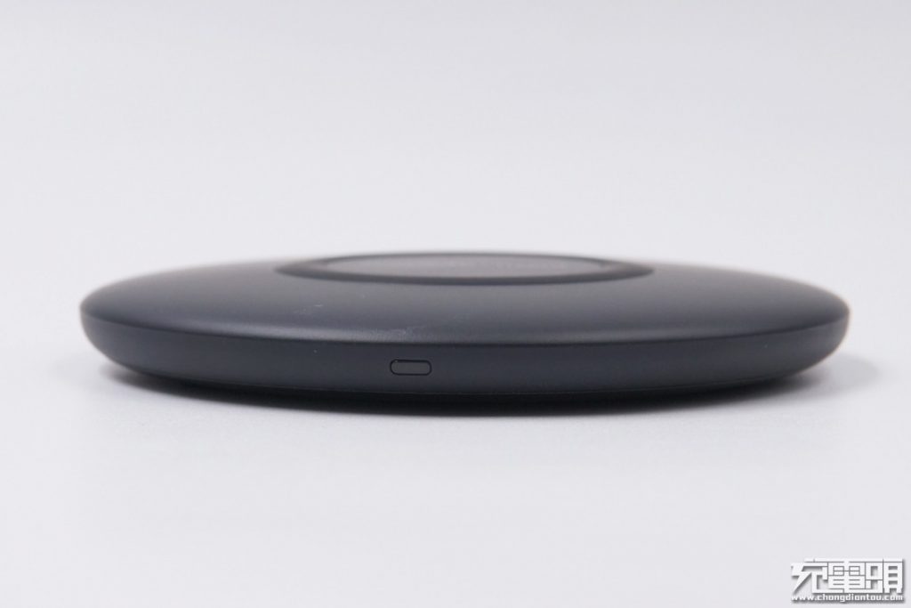

There is an LED indicator on the side which emits different colors to indicate the status.

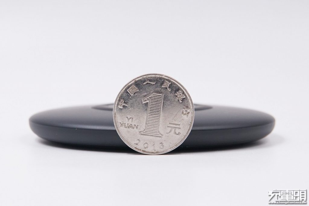

A slim design of merely 11.9mm (0.47in) thickness.

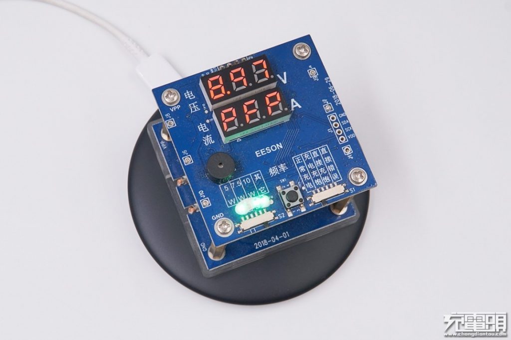

Using the wireless charging aging tester, we read a "PFP" which means it passed the 5W and 10W test but fails the 7.5W test. So it supports normal 5W and Samsung 10W, but does not support Apple 7.5W wireless charging.

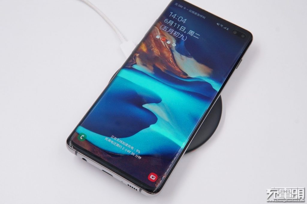

It starts charging instantly when we put the Samsung Galaxy S10+ on top, the screen shows the phone is getting fast wireless charging.

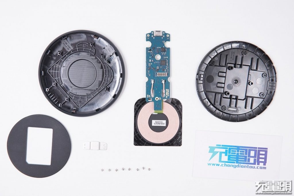

II Teardown
Samsung Wireless Charger Pad Slim (EP-P1100) Teardown Review-Chargerlab
Removing the rubber pad on the bottom reveals 5 screws.
Remove the back cover. Inside is a circuit board with input pins and coil pads.
There are two chips on the circuit board, which are wireless charging IC and MCU.

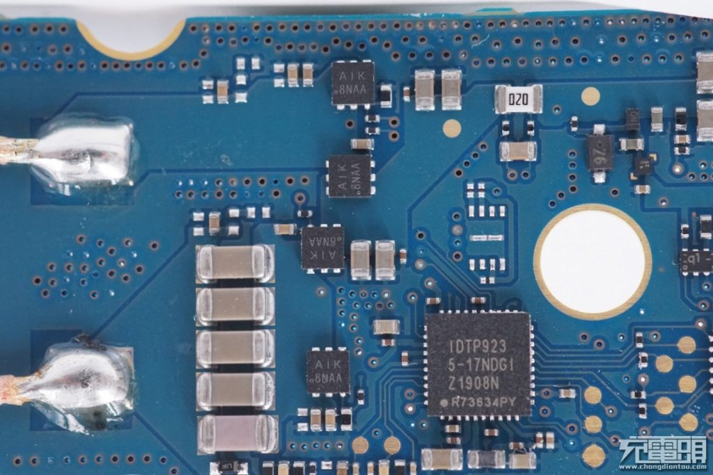

The coil is soldered to the board through the opening on the board. The solder joint is round and full. The right side is the resonant capacitor, the MOS transistor, IDT IDTP9235 and ABOV MCU are used to apply for the voltage.

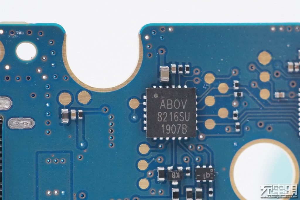

ABOV 8216 MCU

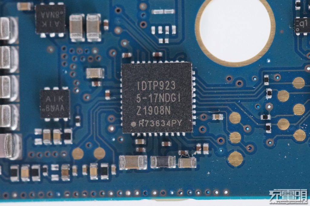

IDT P9235 wireless charging controller IC.
Four MOS tubes form an H-bridge, which performs wirelessly charging with a resonant capacitor drive coil.

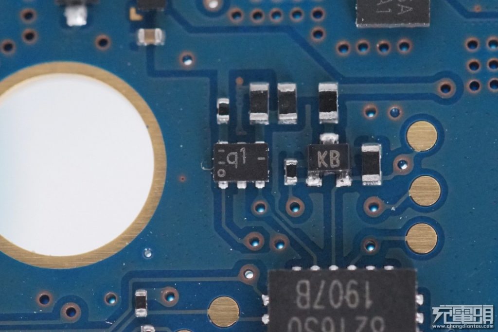

Input overvoltage and overcurrent protection components to avoid damage to the charger.

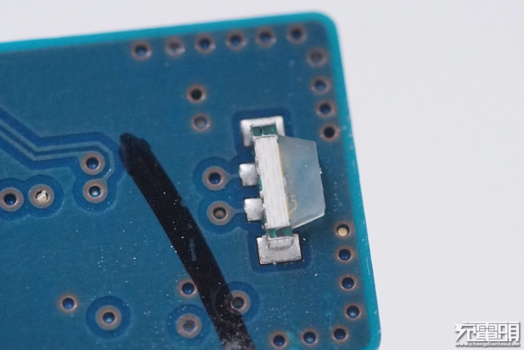

The triode besides the MCU.

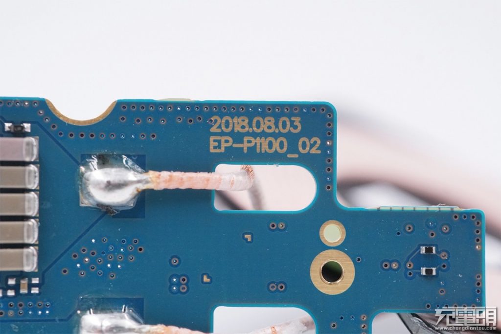

2018 08 03 EP-P1100_02.

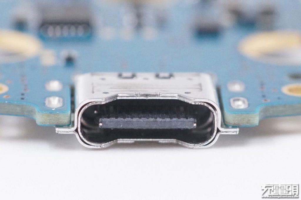

USB Type-C port by LS.

The USB-C port is reinforced by a steel casing.

All the components.
