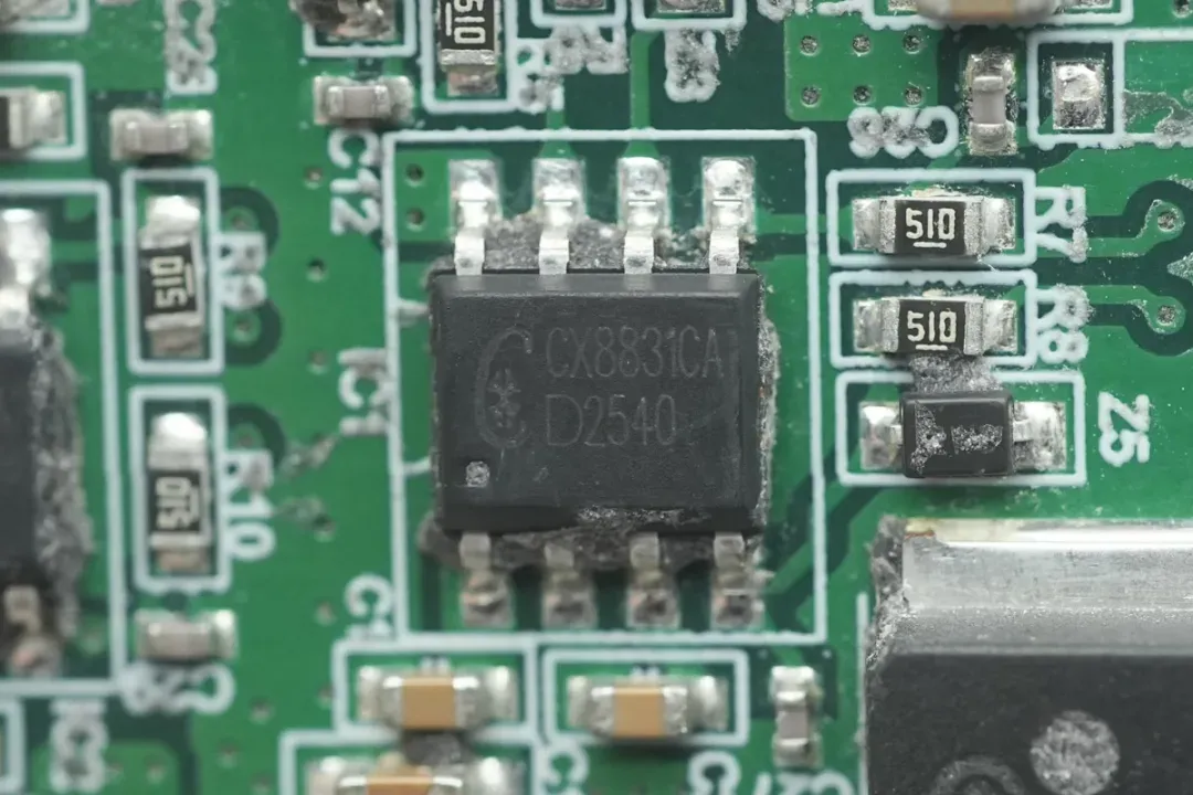

The trend in modern electronics is simple: smaller is better. To meet the shrinking footprints of automotive hubs and portable power stations, CXW has launched the CX8831CA. This DC step-down SoC packs a powerful punch, combining the buck converter, protocol controller, and power MOSFETs into a single ESOP-8L chip. It’s a total game-changer for manufacturers looking to ditch bulky, multi-chip designs in favor of a lean, high-efficiency architecture.

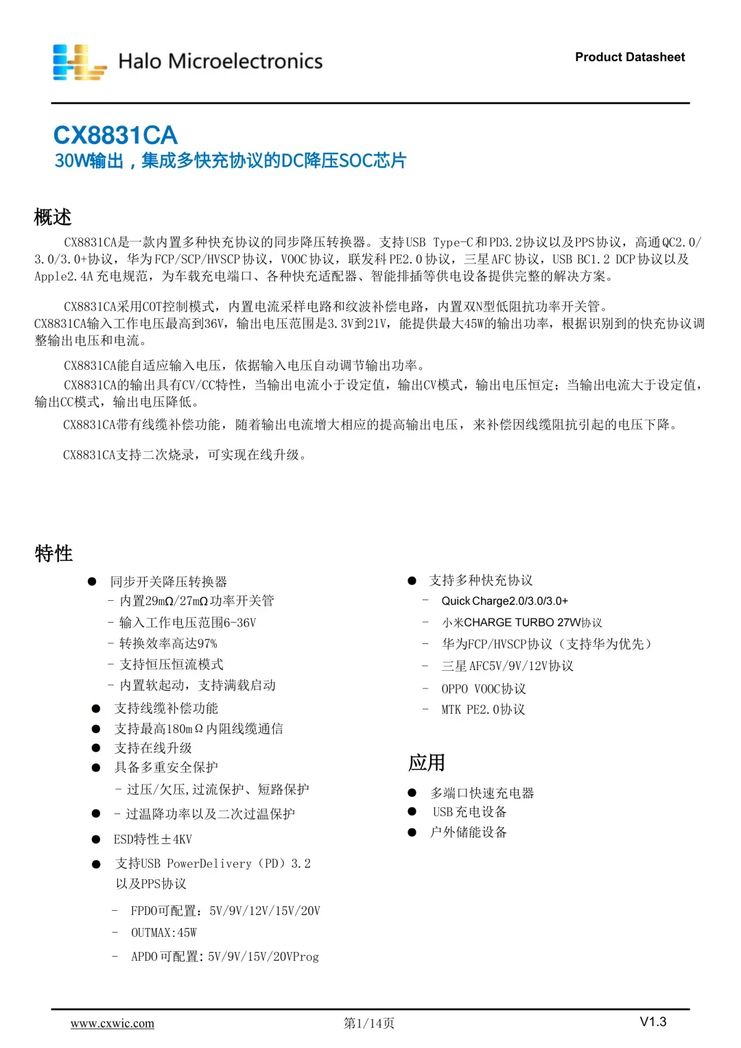

The CX8831CA is built for performance. With a 36V input tolerance and peak efficiencies hitting 97%, it keeps things cool even under heavy 30W loads. Thanks to its advanced COT control and low-resistance MOSFETs, it handles everything from PD3.2 and PPS to VOOC and Huawei’s proprietary fast-charging protocols without breaking a sweat. It’s also packed with intelligent features like cable-loss compensation and a dual-stage thermal protection system, ensuring that your device charges safely and stays reliable over time.

This isn't just theory—the CX8831CA is already hitting the road. It has been confirmed as the core power controller in the Tesla Model 3 (Highland) center console dock. By consolidating protocol management and power conversion into one chip, CXW enabled a tiny, highly reliable 30W charging solution that fits perfectly into the tightest automotive spaces. It’s the definitive standard for "less is more" in DC-DC power design.
