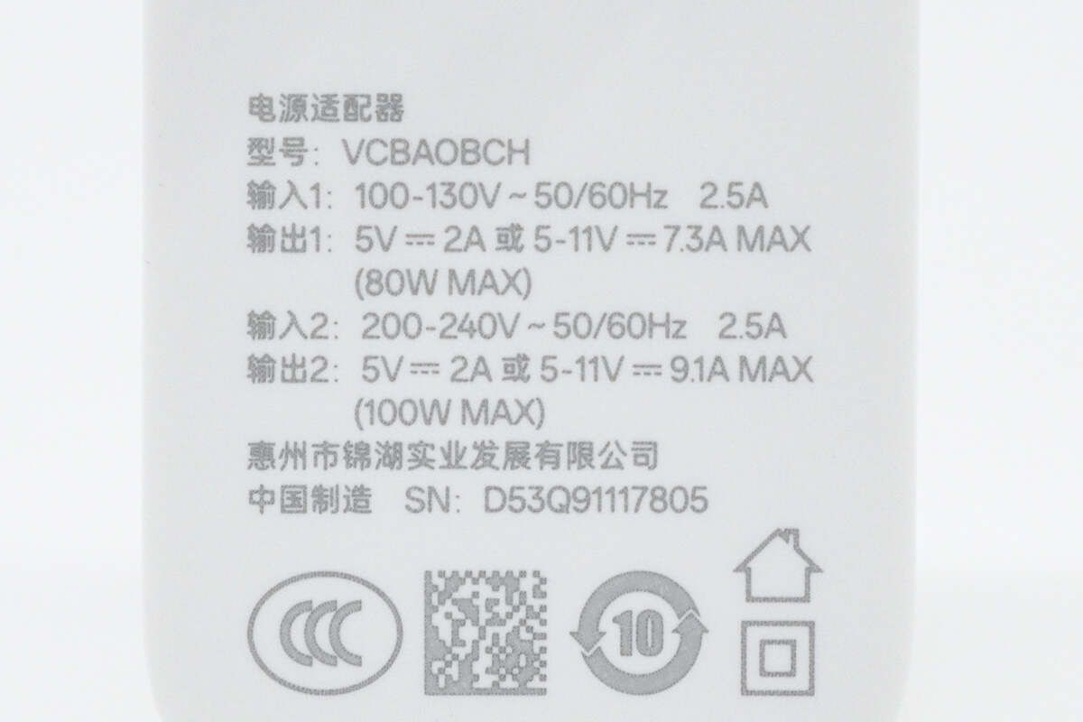

Compatibility Test of OPPO Find X8 Ultra-Chargerlab
The included OPPO 100W charger, model VCBAOBCH, comes with a USB-A port.
Input 1: 100-130V~50/60Hz 2.5A;
Output 1:5V-2A or 5-11V-7.3A MAX(80W MAX);
Input 2: 200-240V~50/60Hz 2.5A;
Output 2:5V-2A or 5-11V-91A MAX(100W MAX)

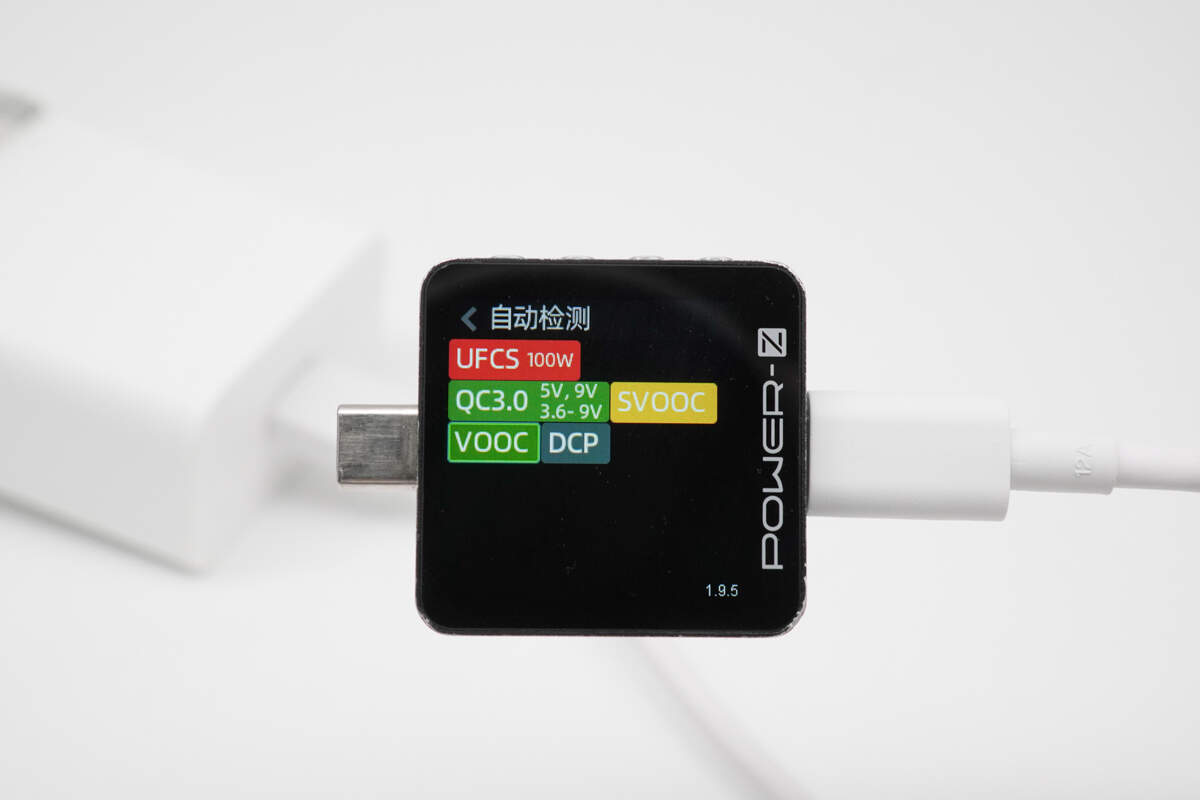

In terms of protocols, it supports UFCS, QC3.0, SVOOC, VOOC, and DCP fast-charging protocols.

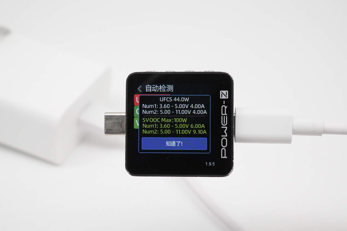

It also has two sets of UFCS fast-charging profiles: 3.6-5V/4A, 5-11V/4A, and two proprietary SVOOC fast-charging profiles: 3.6-5V/6A, 5-11V/9.1A.

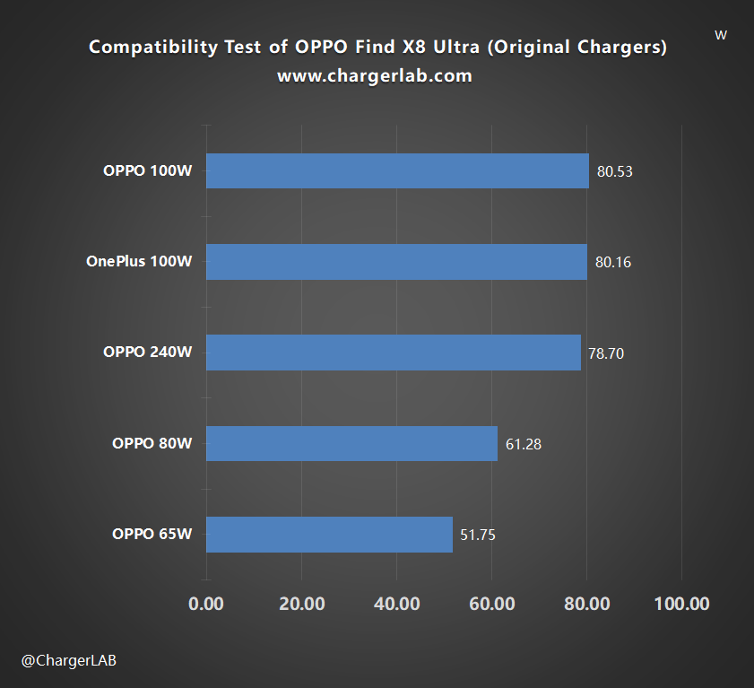

Testing OPPO’s own chargers one by one, all paired with the original cable, the actual charging power of the phone could reach up to around 80W.
Plotting the charging data into a bar chart, we can see that the highest power came from the included OPPO 100W charger at 80.53W, followed closely by the OnePlus 100W charger. From the chart, it is clear that the phone has excellent compatibility with original-brand chargers, as all tested chargers achieved fast-charging power.

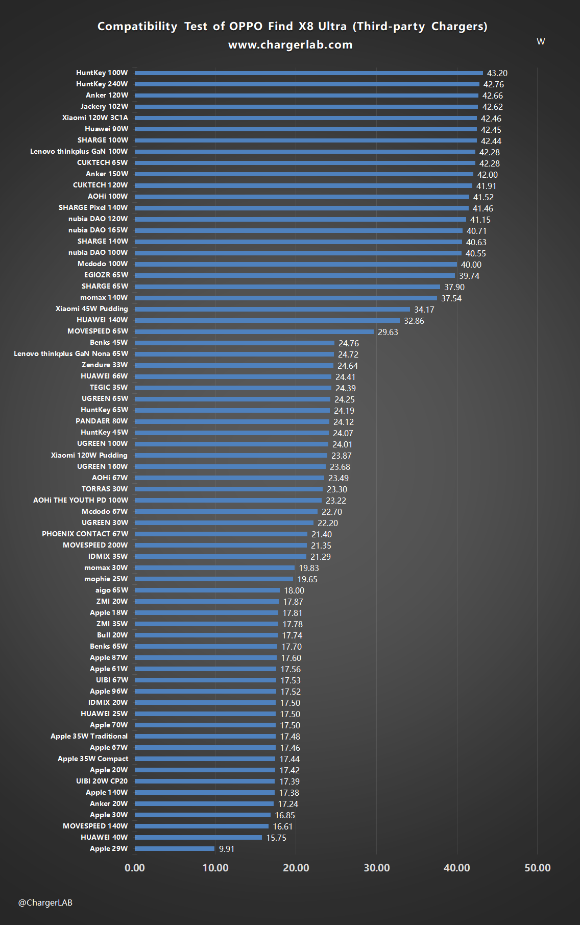

After looking at the compatibility data with original chargers, let’s see how this phone performs with third-party chargers. For this test, we selected over one hundred chargers, with the detailed results as follows.
Using the Jackery 102W charger, the measured charging power for the phone was 8.58V 4.96A 42.53W.
Summarizing the compatibility test data of third-party chargers paired with the original cable, the results were very stable. Charging generally triggered the 9V voltage level, with only a few special chargers triggering the 5V level. The charging current ranged between 2-5A, and overall power was stable.
Plotting the charging data into a bar chart, the highest power in this test came from the HuntKey 100W charger at 43.2W, followed by the HuntKey 240W charger at 42.76W. Both triggered the 5A PPS protocol, and chargers that triggered this protocol all reached above 40W charging power. Chargers in the 20-40W range triggered the 2-3A PPS protocol, while those around 17W triggered the PD protocol.
