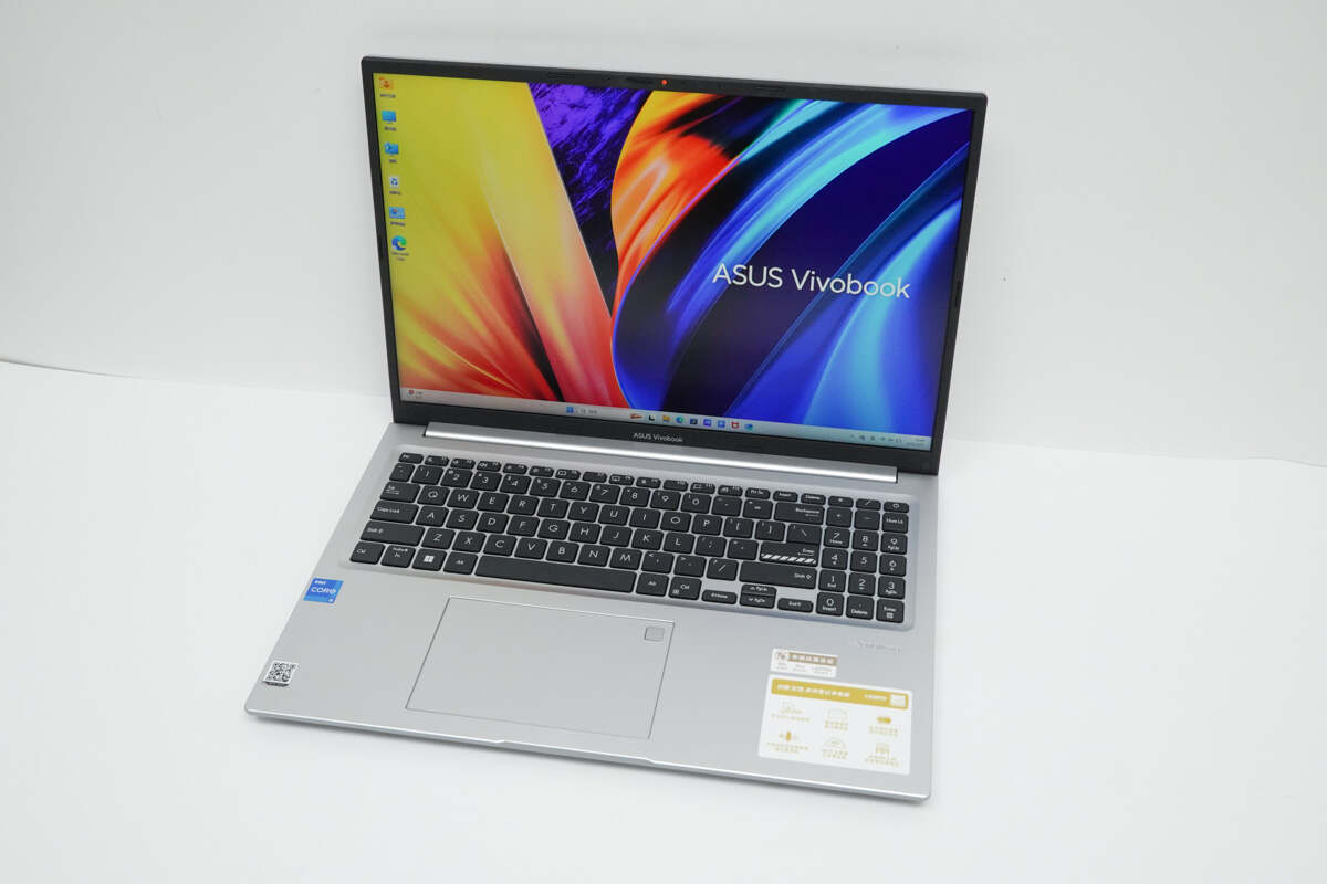

The ASUS Vivobook series is designed specifically for the younger generation, combining a bold aesthetic with a lightweight design, powerful performance, top-tier display technology, and an intelligent user experience. Its daring color options have become a stylish symbol of self-expression.
The Vivobook 16 is equipped with the latest 13th Gen Intel® Core™ i5 high-performance processor and a stunning 16-inch 3.2K OLED display that delivers vibrant, eye-friendly visuals. The NanoEdge narrow bezel design and innovative ErgoLift hinge—capable of a 180° lay-flat angle—enhance usability and comfort.
Additional thoughtful features include an antibacterial silver-ion coating for hygiene and AI-powered two-way noise cancellation for clear communication. Whether you're working efficiently, designing creatively, or enjoying immersive entertainment, the Vivobook 16 is engineered to empower you with both personality and performance.

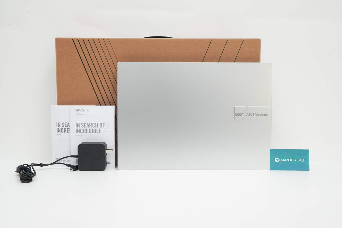

The box contains the ASUS Vivobook 16, a 65W DC charger, and some documents.

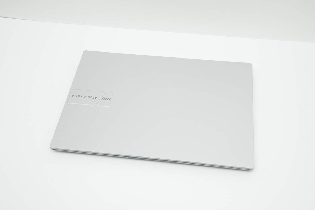

The top cover features ASUS Antibacterial Guard Plus, effectively inhibiting 99% of bacteria and flu viruses for enhanced hygiene. It has a smooth, refined texture with the ASUS Vivobook logo in the top left corner.

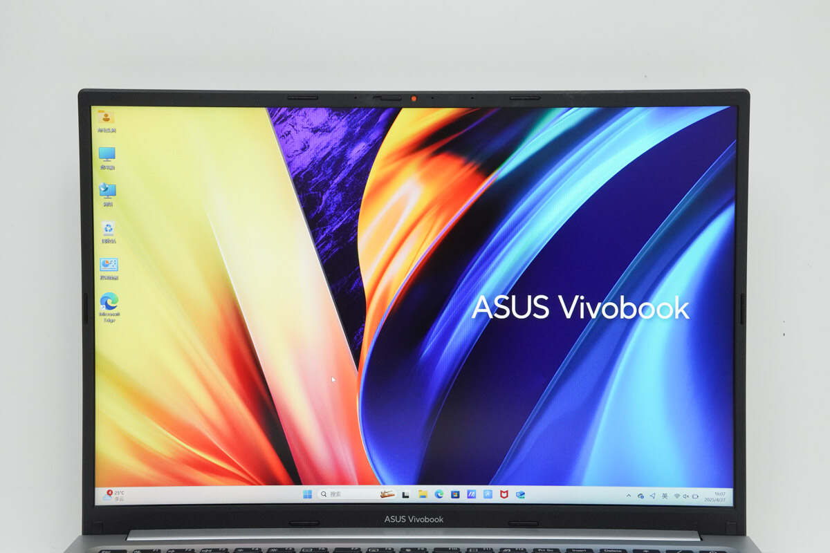

It features a three-sided NanoEdge design with slim bezels and a 16:10 aspect ratio, housing a 16-inch 2.5K high-refresh-rate display. With a 144Hz refresh rate and 100% sRGB color gamut, it delivers exceptional visual clarity and smoothness. This sharp, immersive display also supports wide viewing angles and is TÜV Rheinland-certified for low blue light, effectively reducing eye strain from harmful blue light.

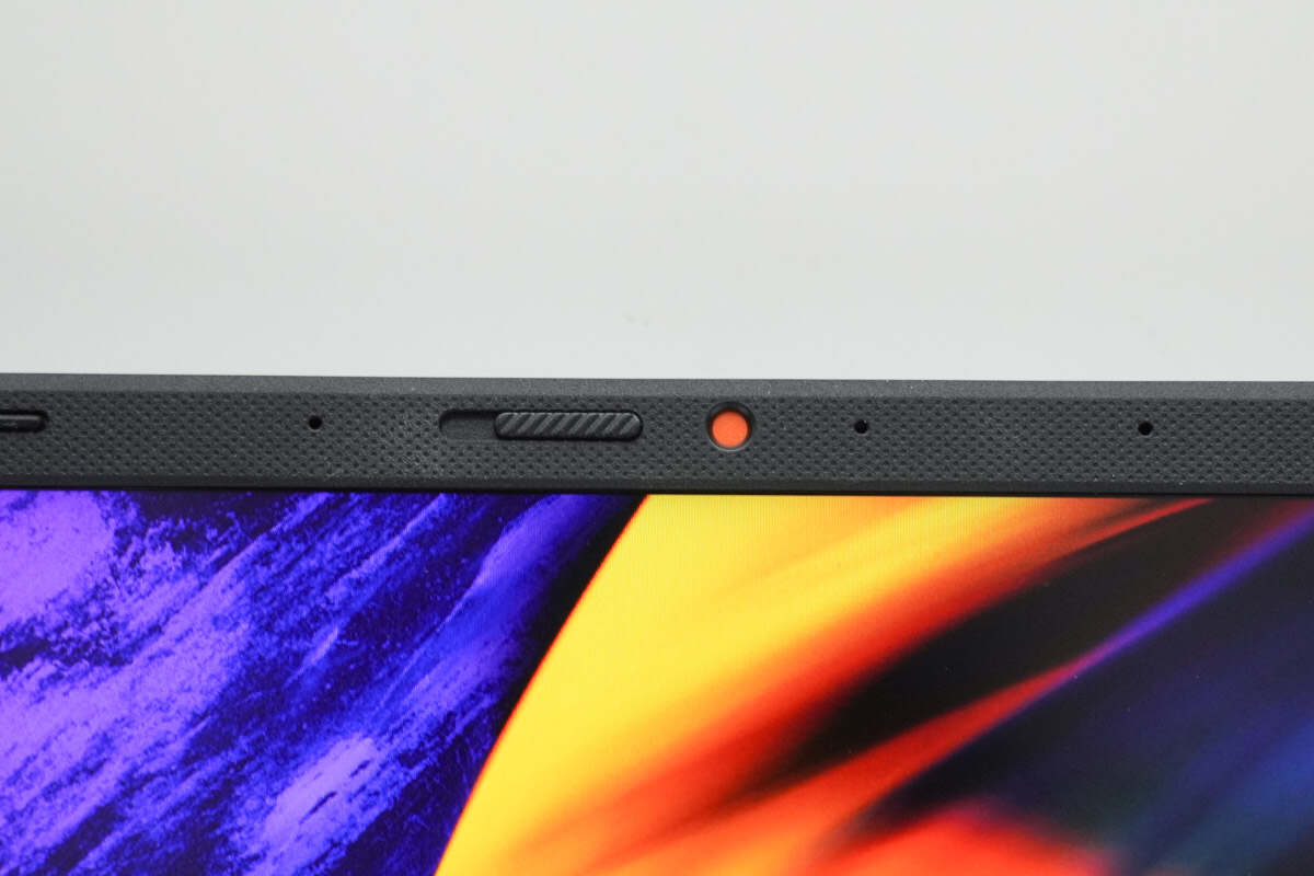

The webcam module includes a physical slide that can be easily slid to block the camera and prevent privacy leaks. There's also a dedicated keyboard shortcut to mute the microphone, with an indicator light to clearly show when it's off.

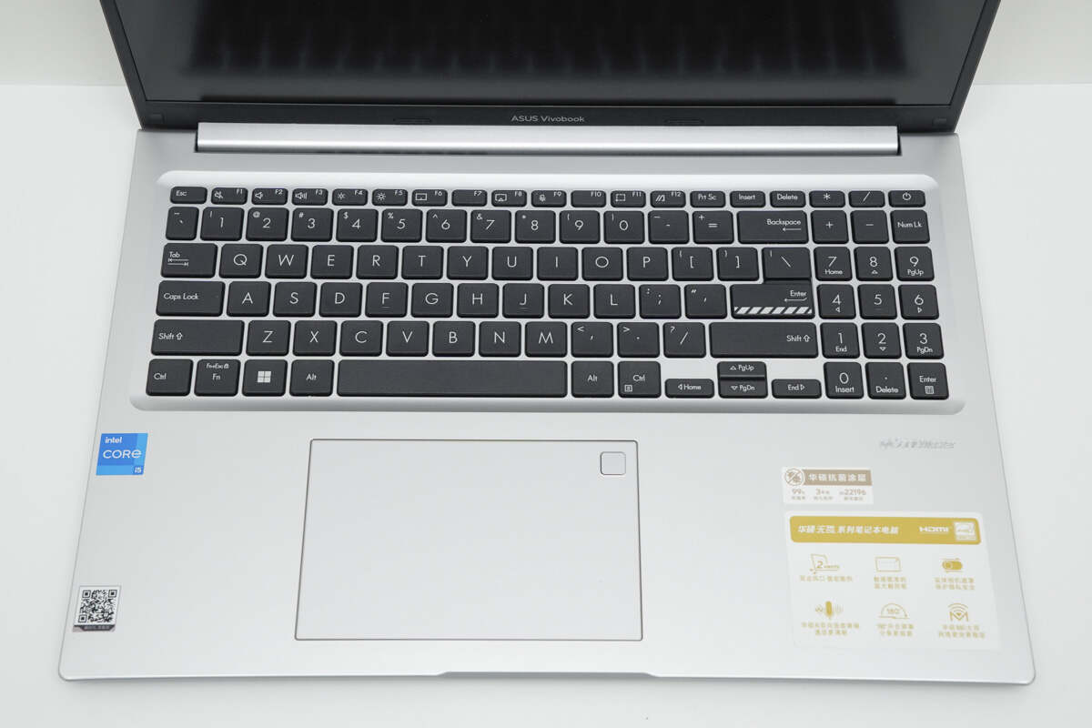

The keyboard deck features the ASUS ErgoSense ergonomic keyboard, complete with a numeric keypad. It offers a full-size 19.05mm key pitch, concave keycaps that fit the shape of your fingertips, and a 1.4mm key travel. The keyboard also supports three-level backlight adjustment.

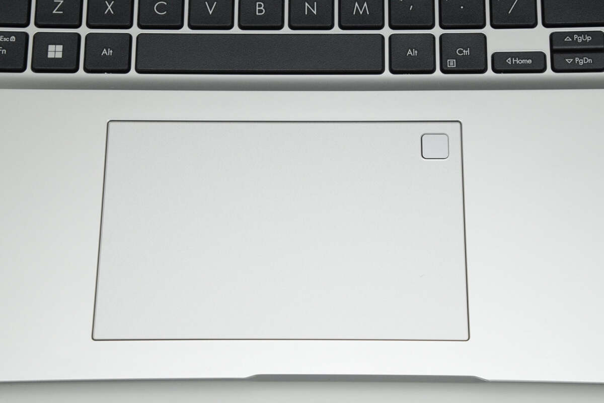

It also features a spacious 6-inch touchpad with a built-in fingerprint sensor in the top-right corner. Compatible with Windows Hello, it lets you log in securely with a single touch, no password needed.

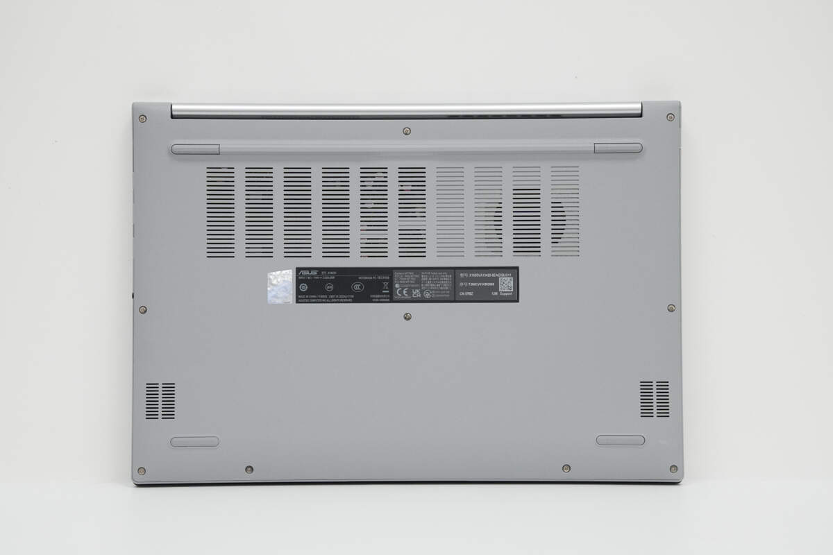

The underside features distributed ventilation openings.
Charging Review of ASUS Vivobook 16-Chargerlab

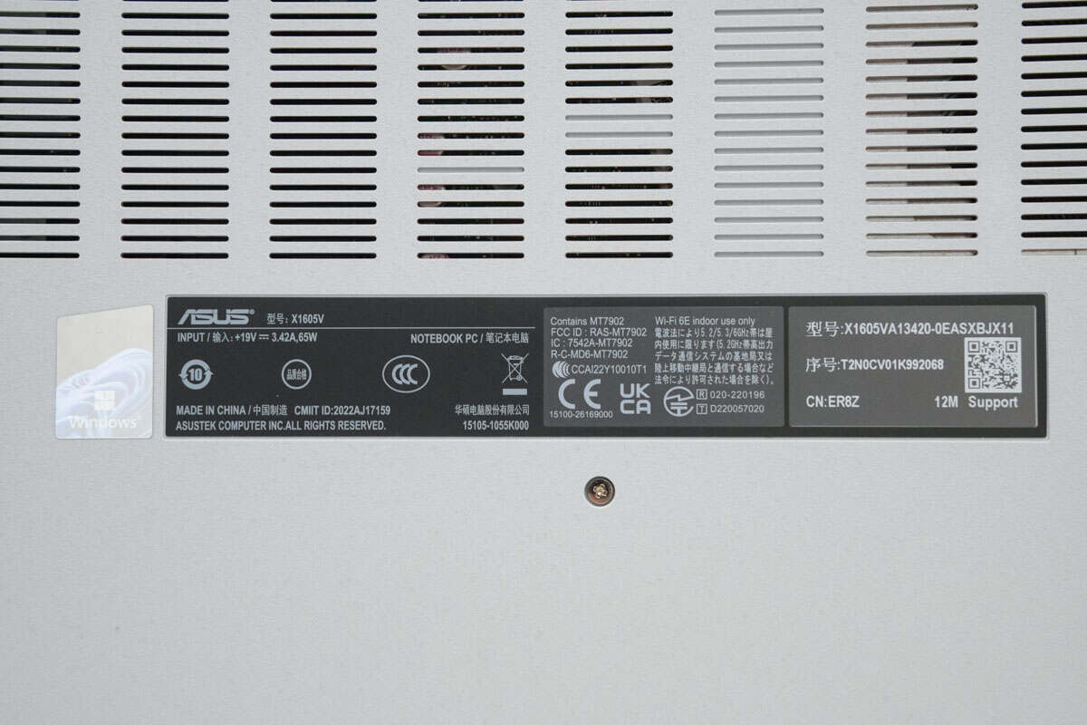

It also includes product information and specifications, and has passed certifications such as CCC, UL, and CE.
Model: X1605V
Input: 19V ⎓ 3.42A, 65W

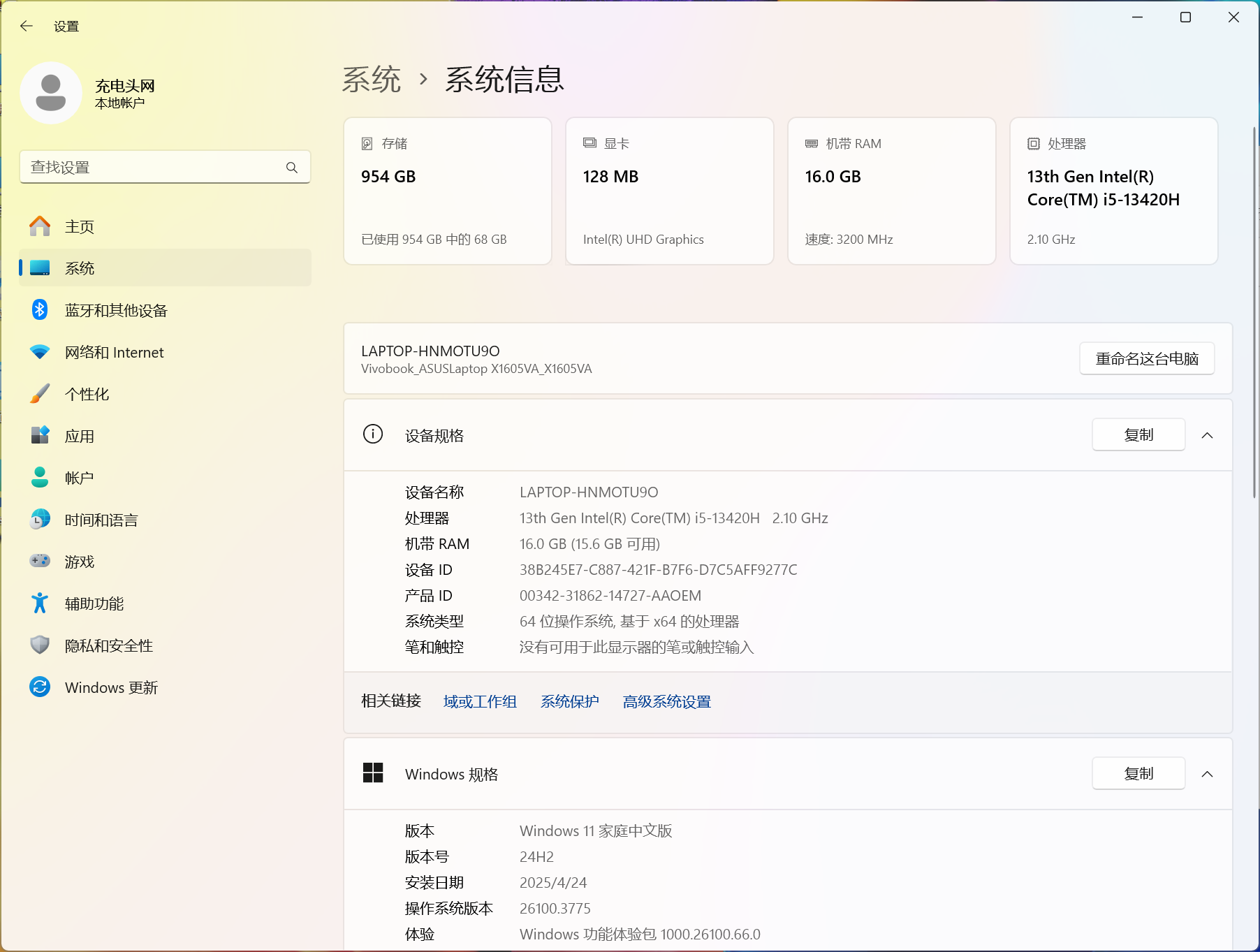

The ASUS Vivobook 16 comes pre-installed with Windows 11 Home and is powered by the 13th Gen Intel® Core™ i5-13420H processor, featuring 8 cores and 12 threads, with a max turbo frequency of 4.6GHz and 45W performance power. It handles complex computations and multitasking with ease.
Additional specs include:
CPU: 13th Gen Intel® Core™ i5-13420H
Graphics: Intel® UHD Graphics
Memory: 16GB LPDDR4 at 3200MHz
Storage: 1TB SSD

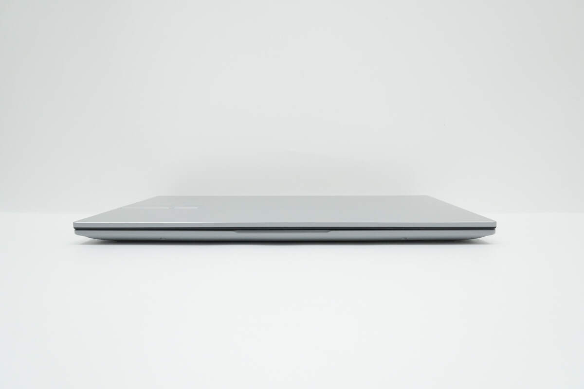

The front bottom edge of the laptop features a recessed design, making it easier to open the screen with one hand.

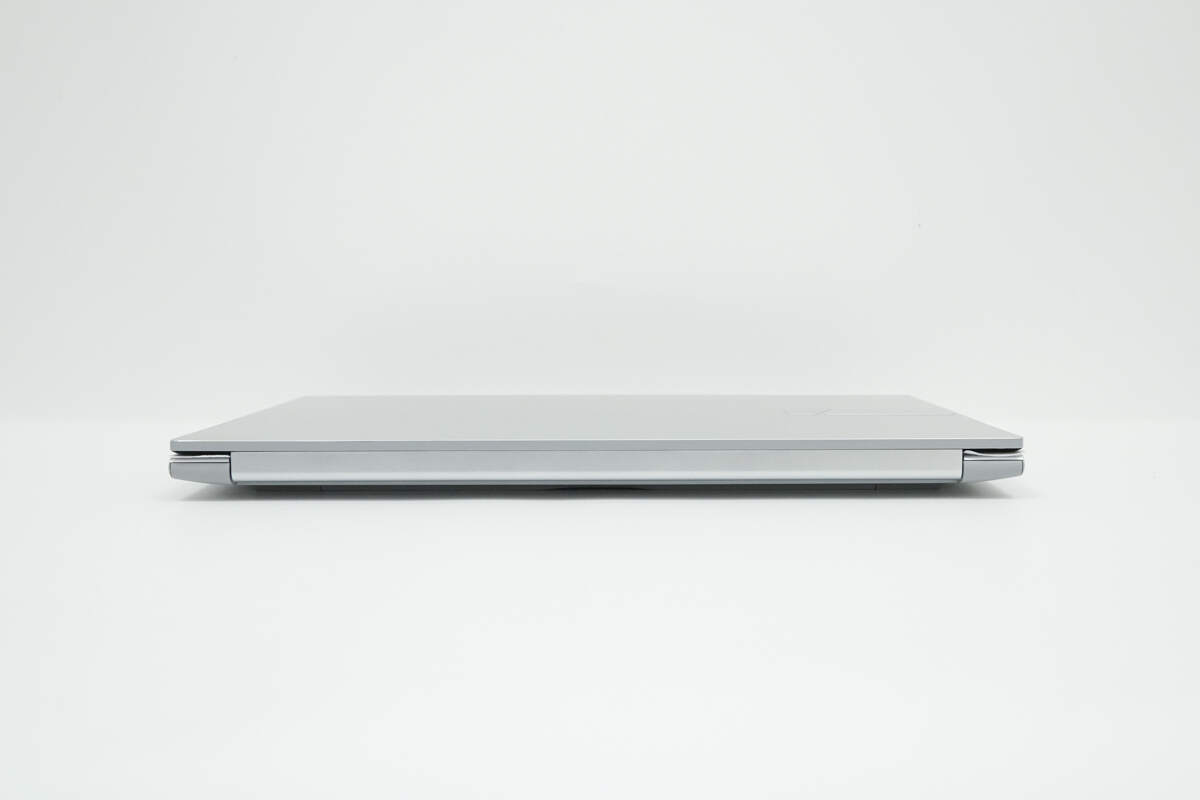

The back of the laptop is very clean, with no ports.

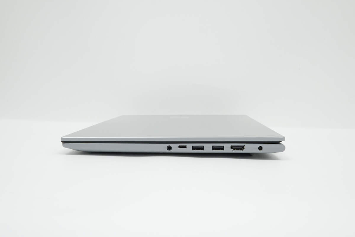

On the right side, from left to right, there is a 3.5mm audio jack, a USB-C 3.2 Gen 1 port with PD charging support, two USB-A 3.2 Gen 1 ports, an HDMI port, and a DC power input.

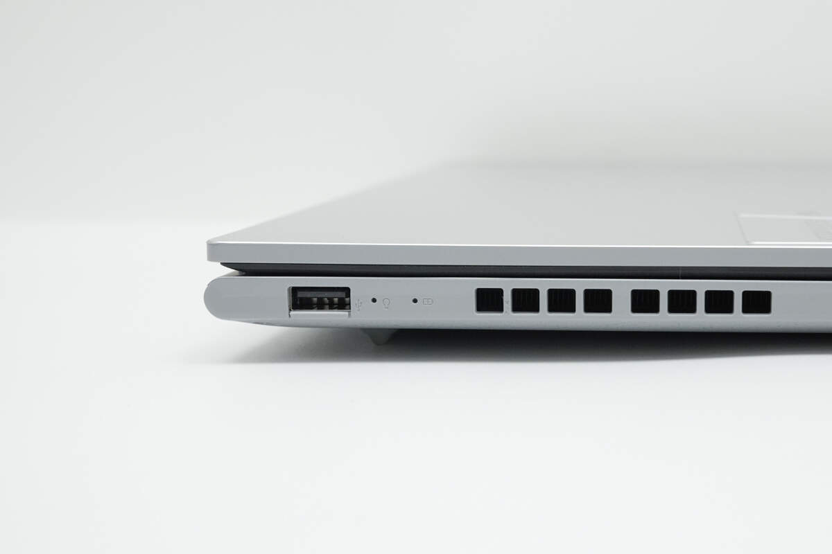

The left side features a USB-A 2.0 port.

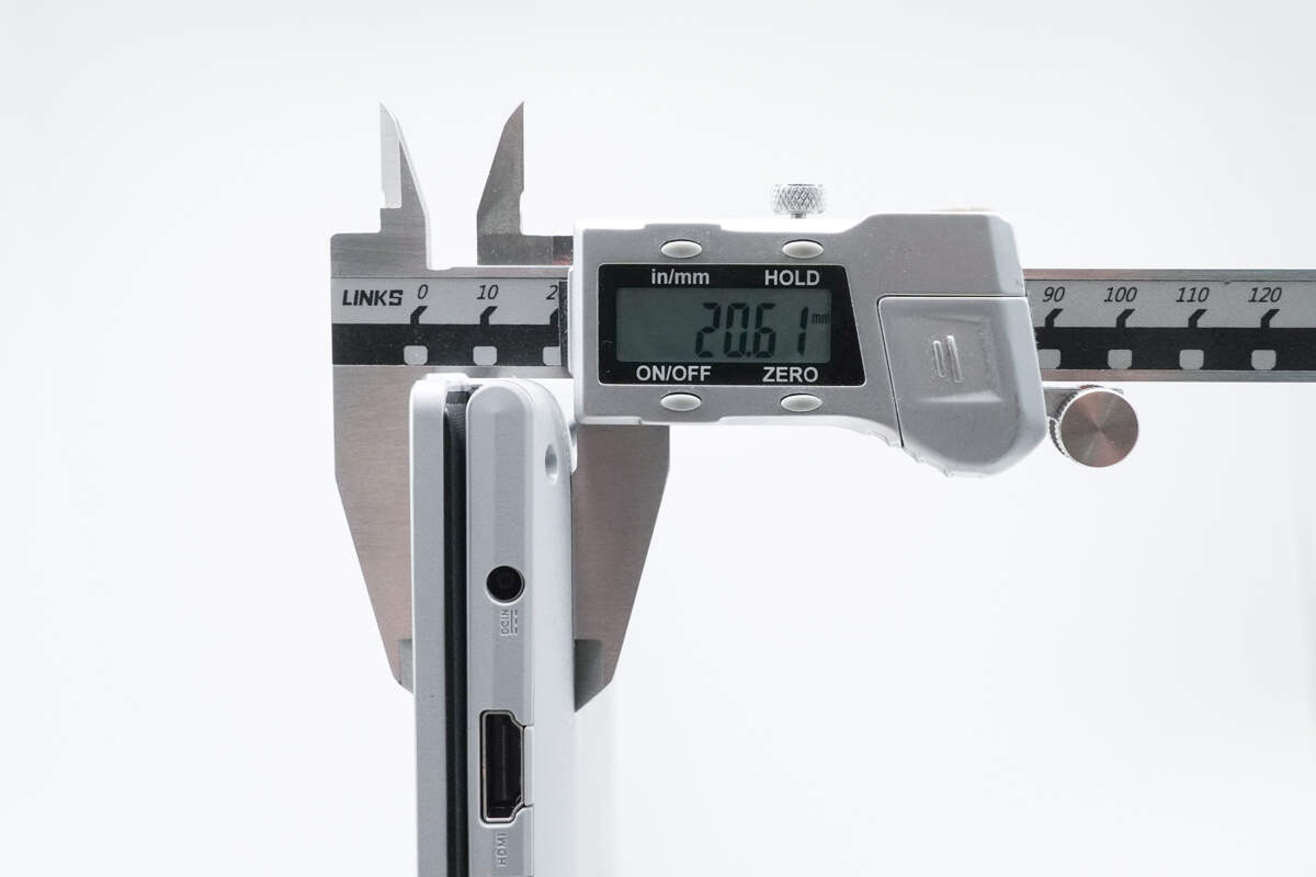

The thickness is about 20.61 mm (0.81 inches).

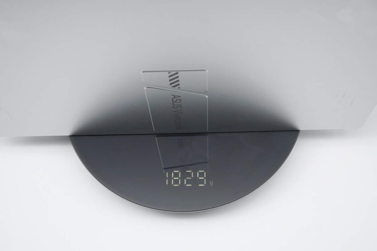

The weight is about 1829 g (64.52 oz).

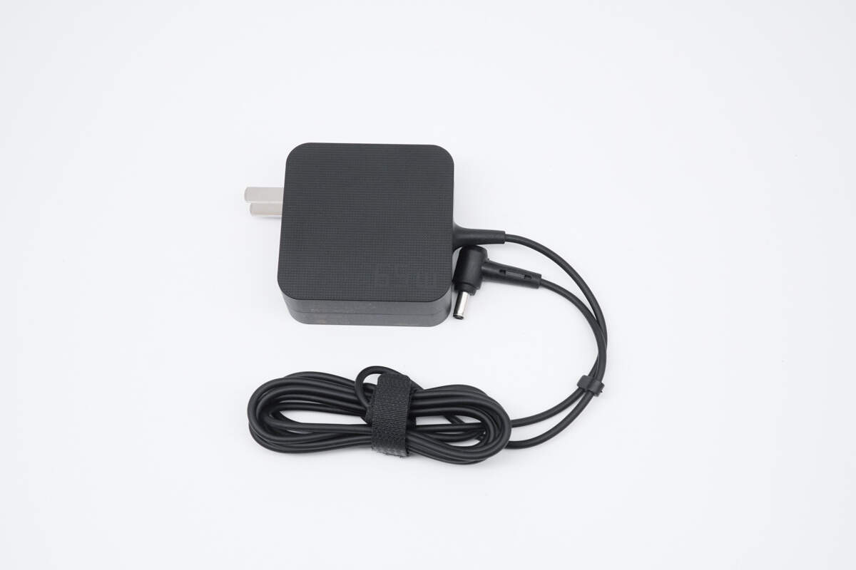

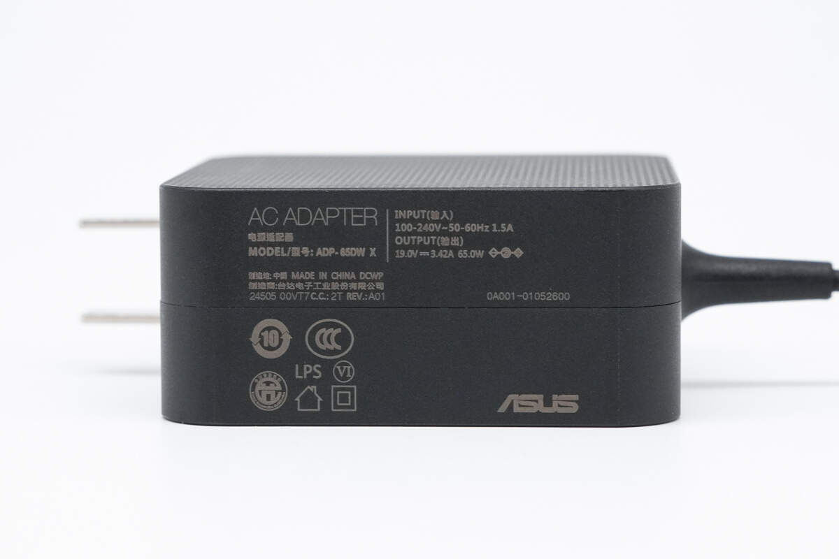

The included charger features a DC interface.
One side of the charger is printed with specifications.
Model: ADP-65DW X
Input: 100-240V \~ 50-60Hz 1.5A
Output: 19.0V ⎓ 3.42A 65.0W

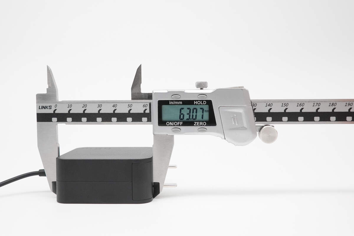

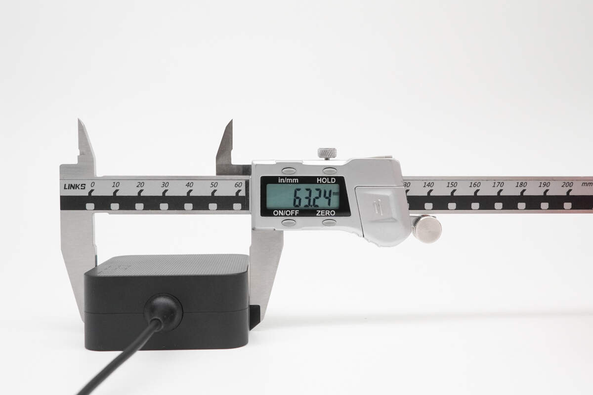

The length of the charger is about 63.24 mm (2.49 inches).
The width is about 63.07 mm (2.48 inches).

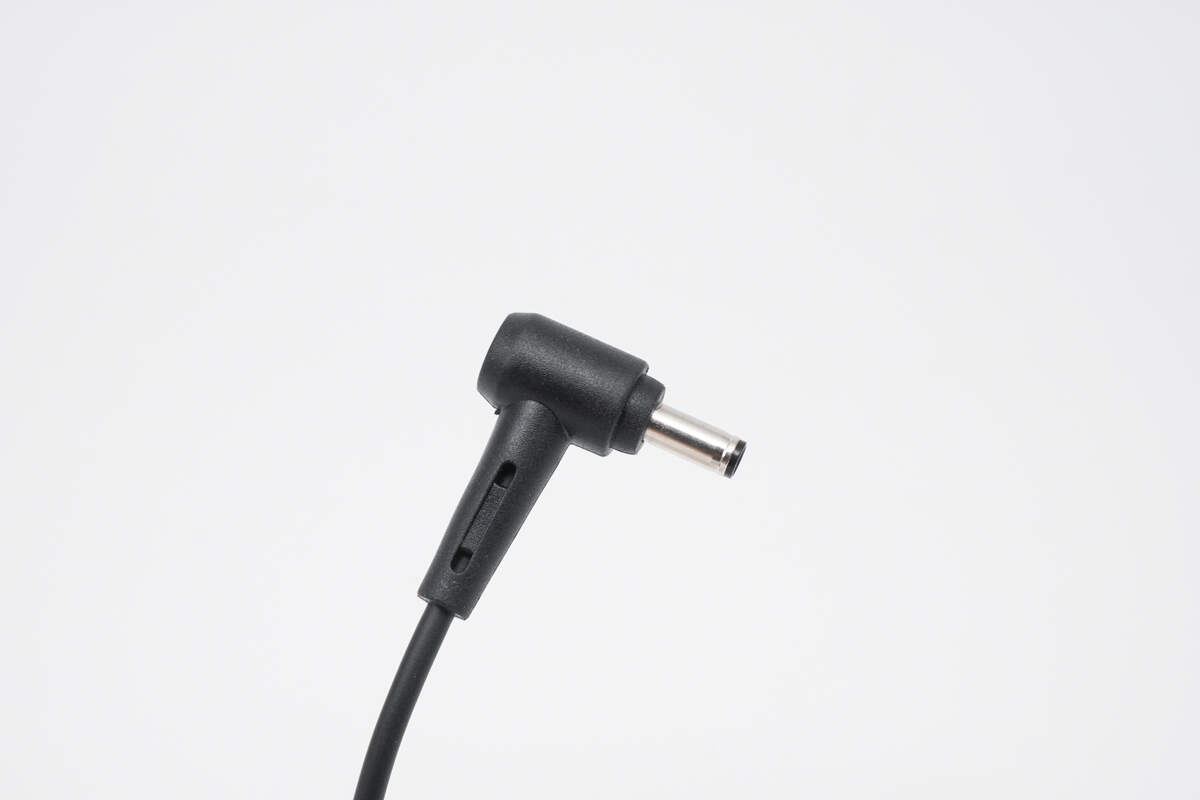

This is the L-shaped DC connector.

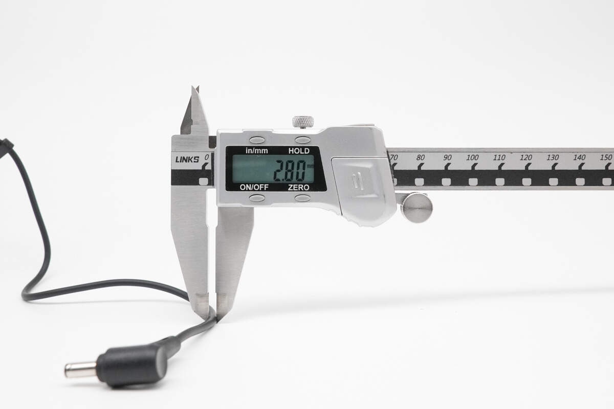

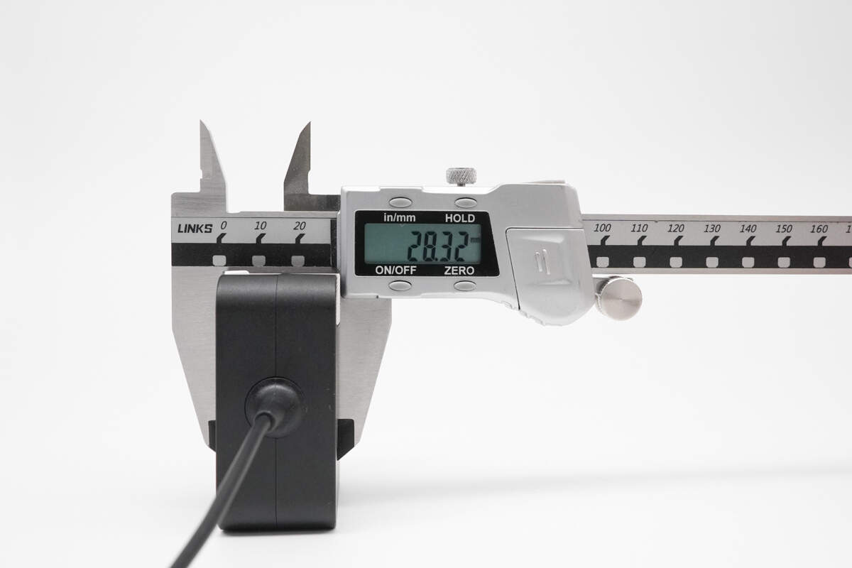

The diameter of the cable is about 2.8 mm (0.11 inches).

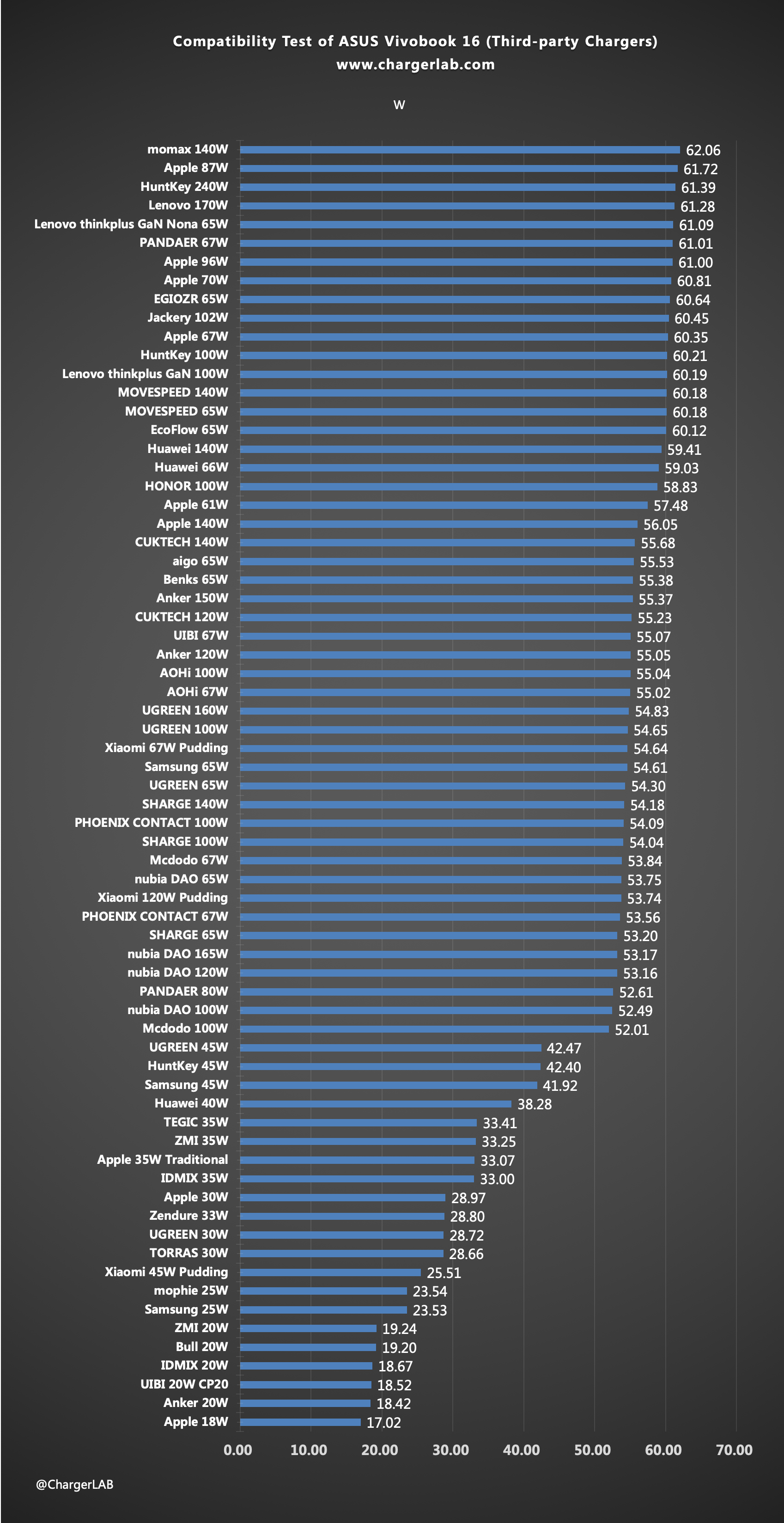

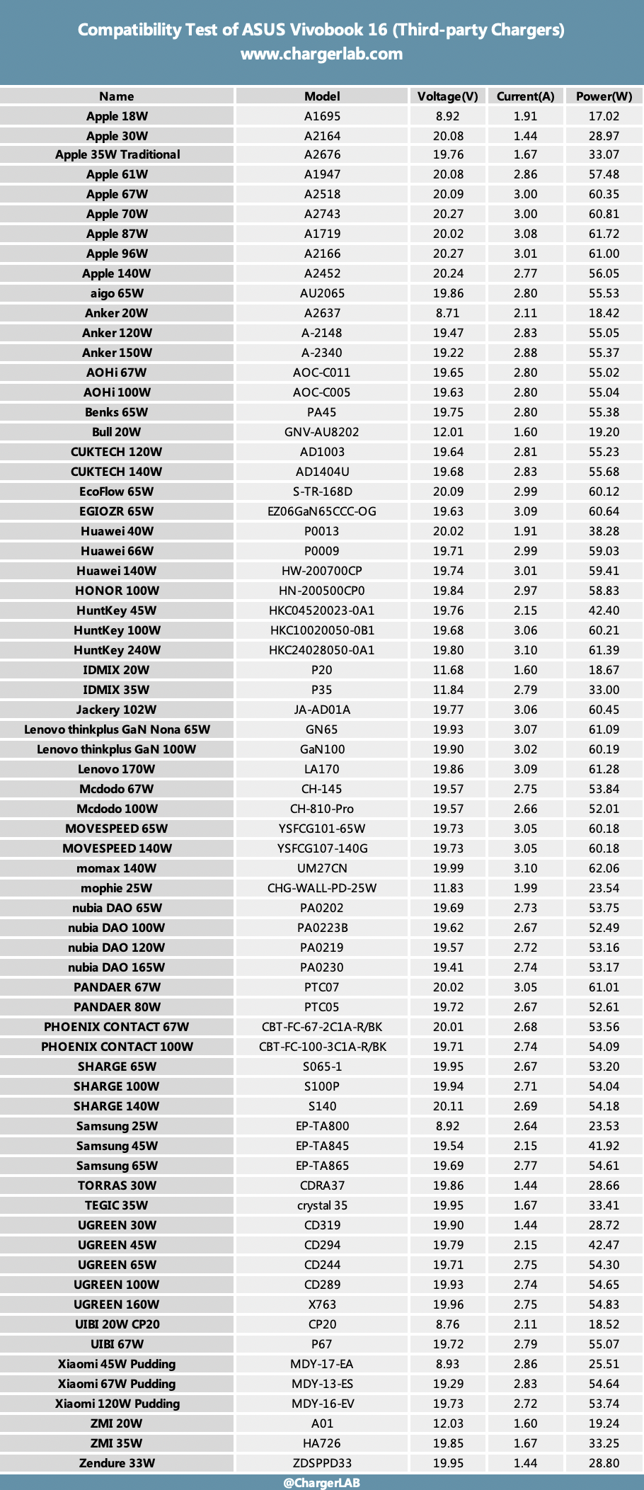

We used a variety of third-party chargers during the test. Let’s take a look at the results.
The test results for third-party chargers are summarized in the table. Most tested chargers delivered stable power output, with the majority achieving a voltage of 20V. A smaller number of chargers, due to power limitations, only reached 9V or 12V.
We have compiled the test results into a bar chart. There are no compatibility issues. Most of the tested chargers can reach the maximum PD fast charging power supported by either the charger itself or the laptop. The majority deliver charging power between 52W and 62W. Lower-power chargers still achieve outputs ranging from 17W to 42W. The highest charging power is 62.06W.

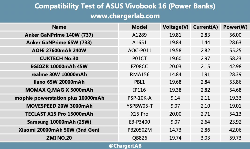

Power Banks
The majority of power banks support 20V charging, while a few operate at 9V or 15V.

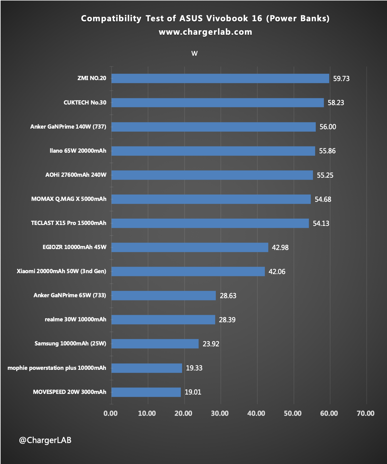

Compiled the test results into a bar chart. There are no compatibility issues. The results are consistent with third-party chargers.

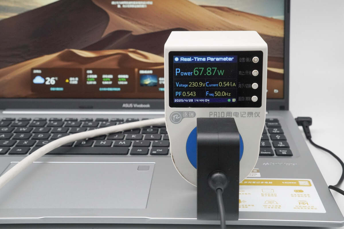

The power meter shows a charging power of up to 67.87W.

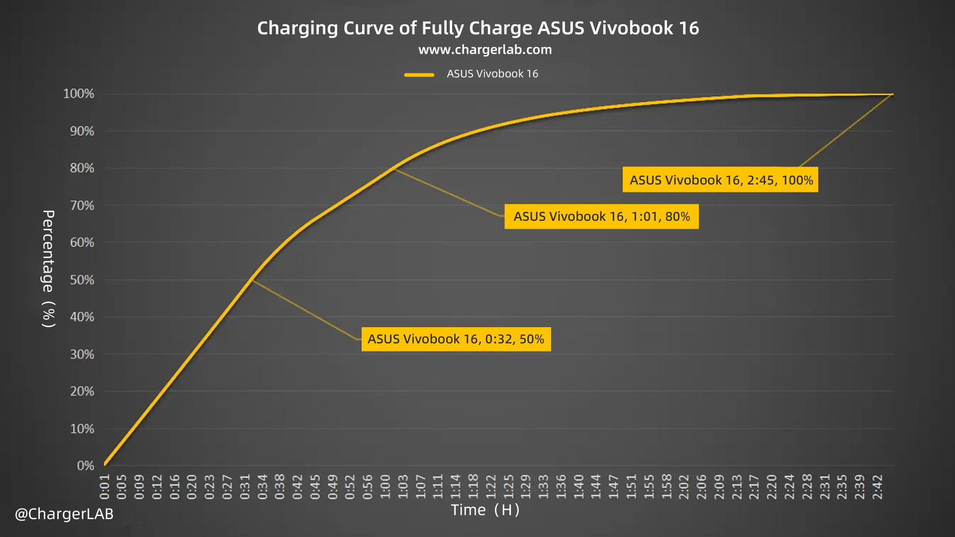

We use the original 65W charger to fully charge the ASUS Vivobook 16. And put them into a 25°C (77℉) thermotank throughout the test.
It reaches 50% in 32 minutes. And it can reach 80% in 1 hour and 1 minute, 100% in 2 hours and 45 minutes.

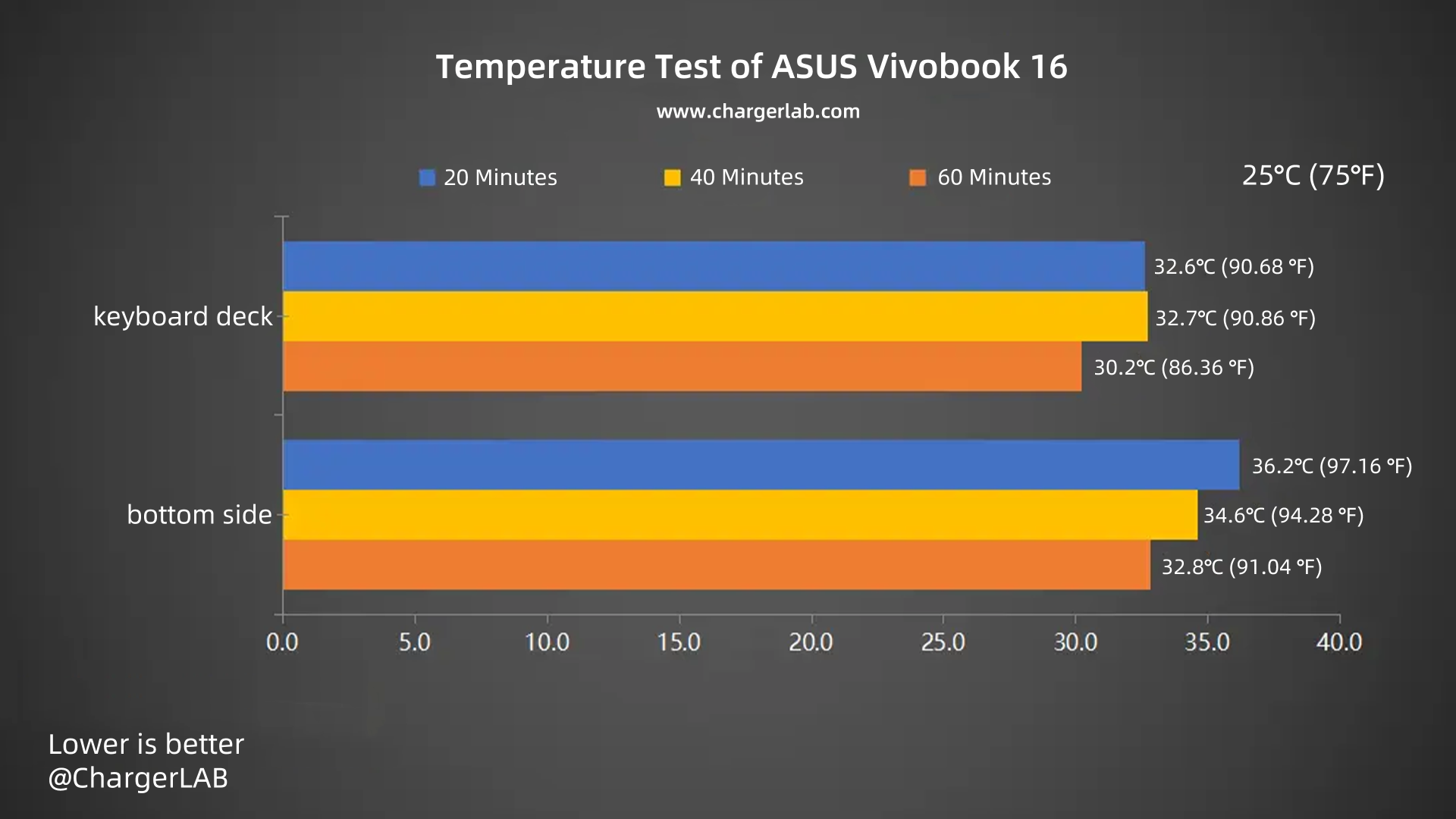

Temperature Test

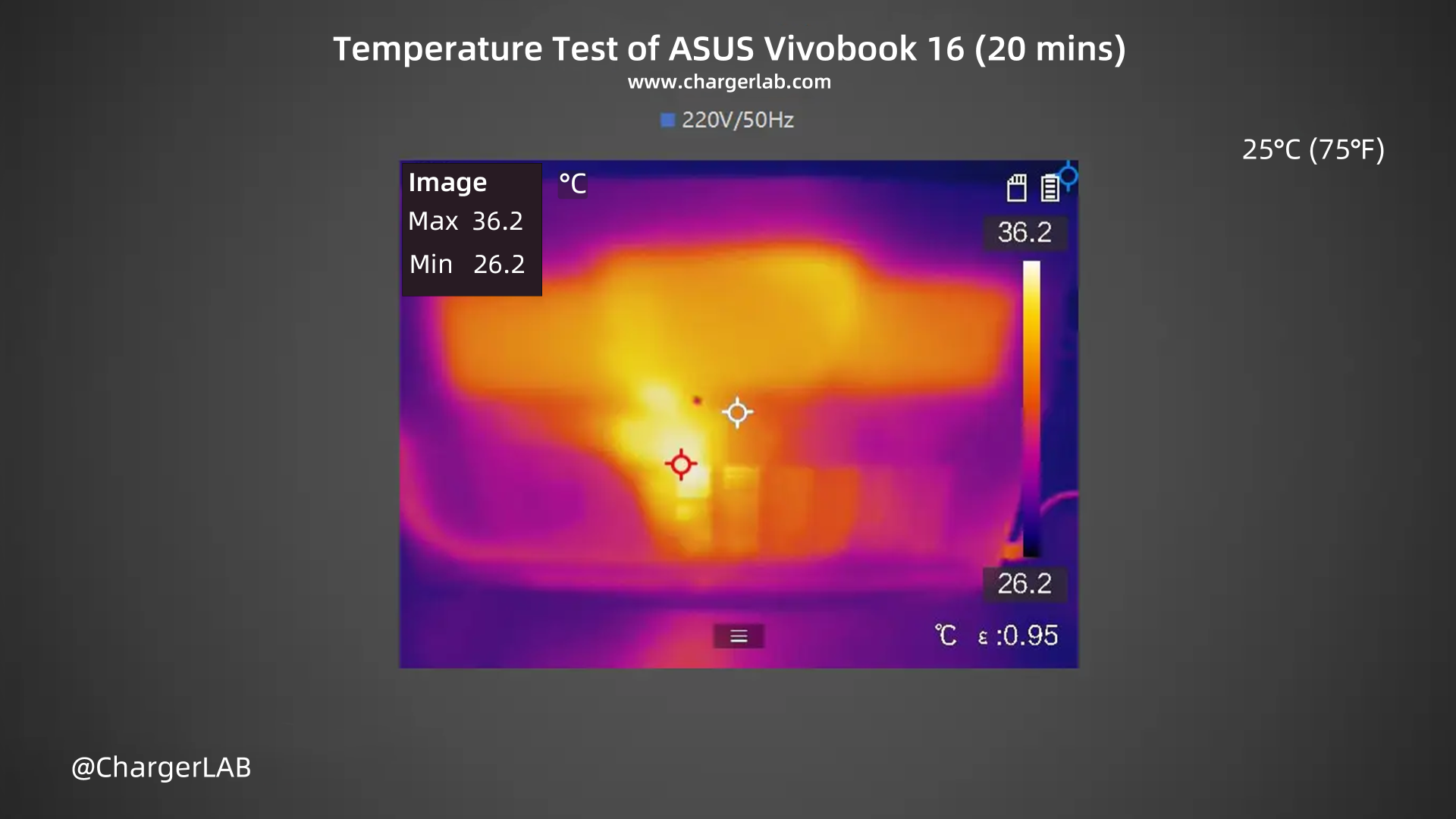

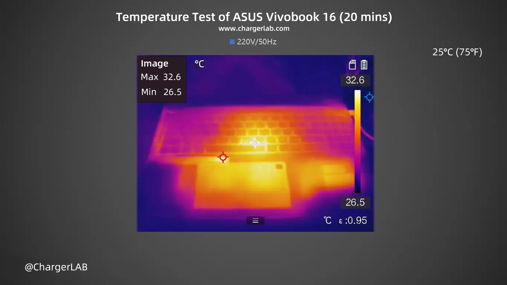

We also recorded the highest temperature on the keyboard deck and bottom side after charging for 20 minutes, 40 minutes, and 60 minutes.
20 minutes Charging
After 20 minutes, the maximum temperature on the keyboard deck is 32.6℃ (90.68 ℉).
The bottom side is 36.2℃ (97.16 ℉).

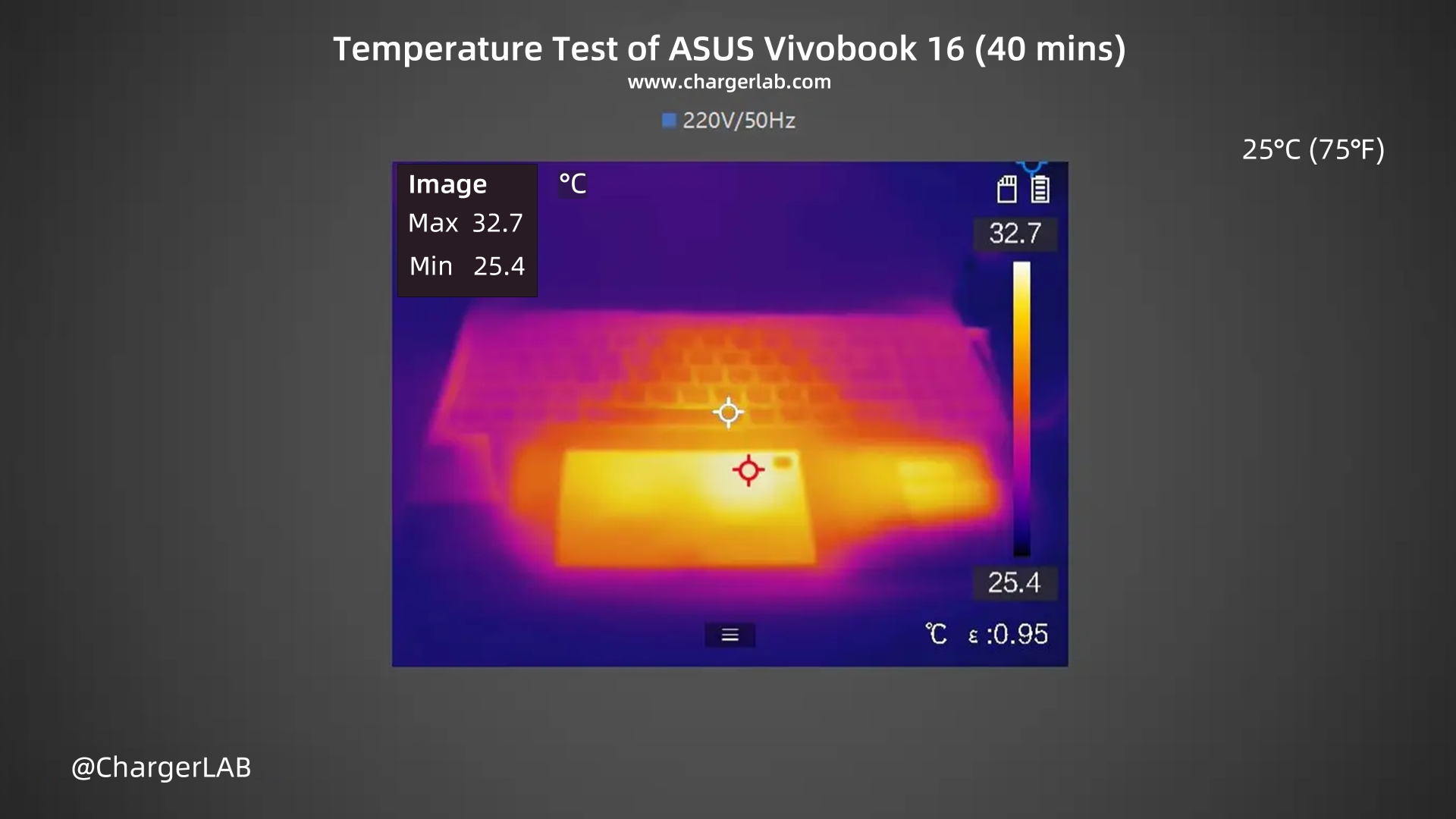

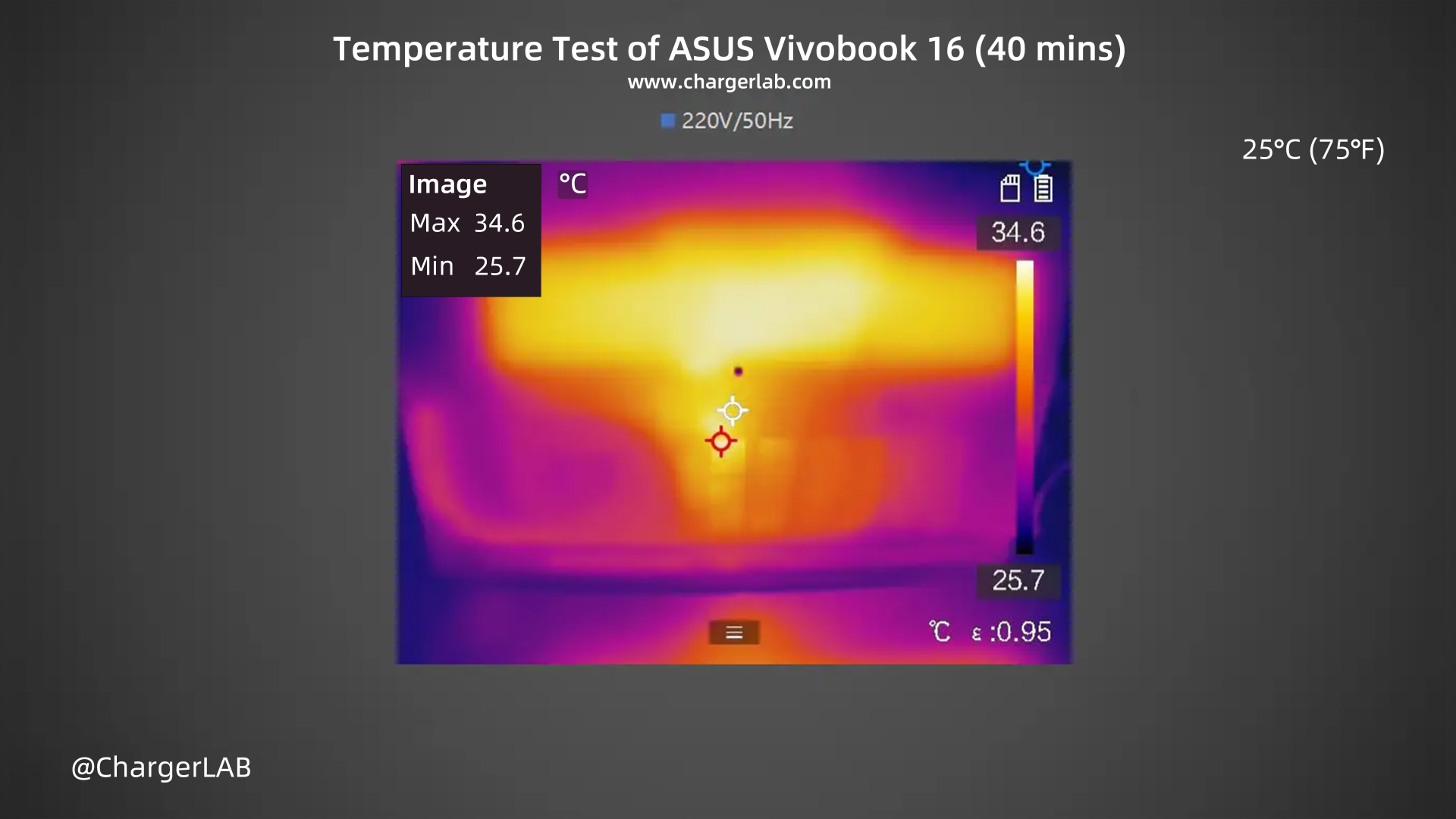

40 minutes Charging
After 40 minutes, the maximum temperature on the keyboard deck is 32.7℃ (90.86 ℉).
The bottom side is 34.6℃ (94.28 ℉).

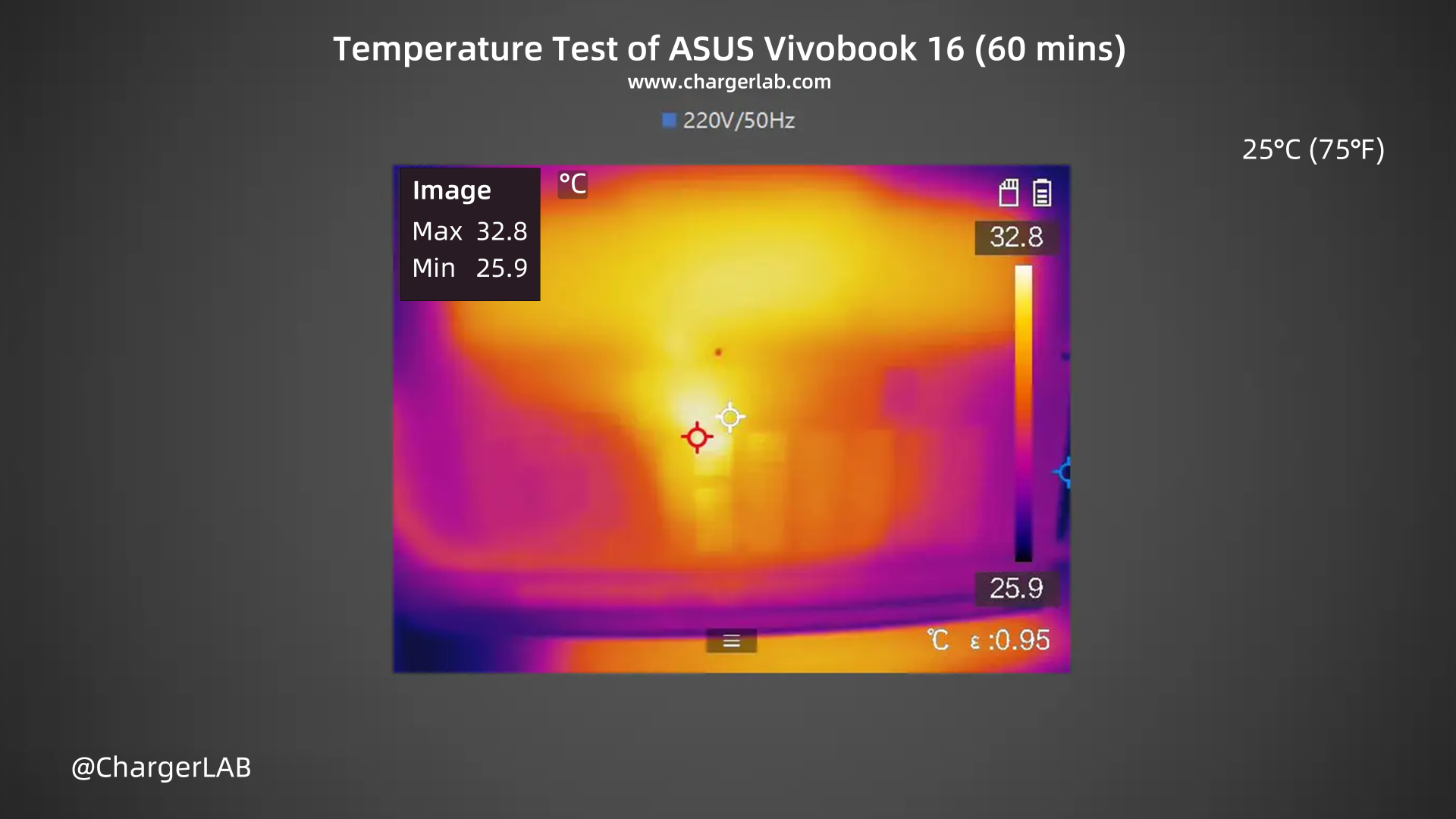

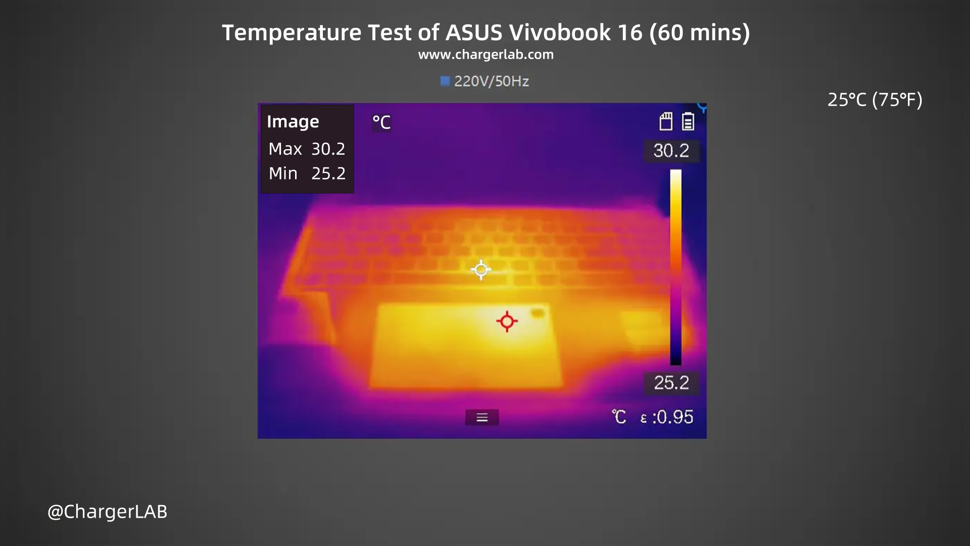

60 minutes Charging
After 60 minutes, the maximum temperature on the keyboard deck is 30.2℃ (86.36 ℉).
The bottom side is 32.8℃ (91.04 ℉).
We also turn it into a bar chart. During charging for 1 hour, the temperature is between 30.3 and 36.2°C. The temperature of the keyboard deck is always lower than that of the bottom side. At its peak temperature, it feels only mildly warm when touched.
