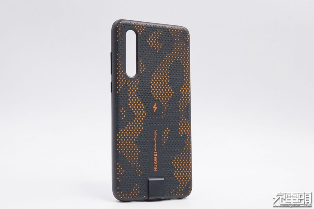

Recently, Huawei has released two flagship models, the P30 and the P30 Pro. Among them, only the P30 Pro has native support for wireless charging. To enable wireless charging for P30, Huawei has released a Huawei P30 wireless charging protective case. This wireless charging protective case supports 10W wireless fast charging, and has passed TÜV Rheinland safety certification and Qi certification. Now, let’s dive into our teardown review.

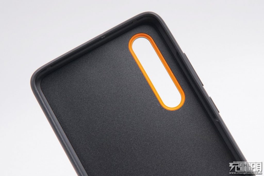

Matte finish on the inside.

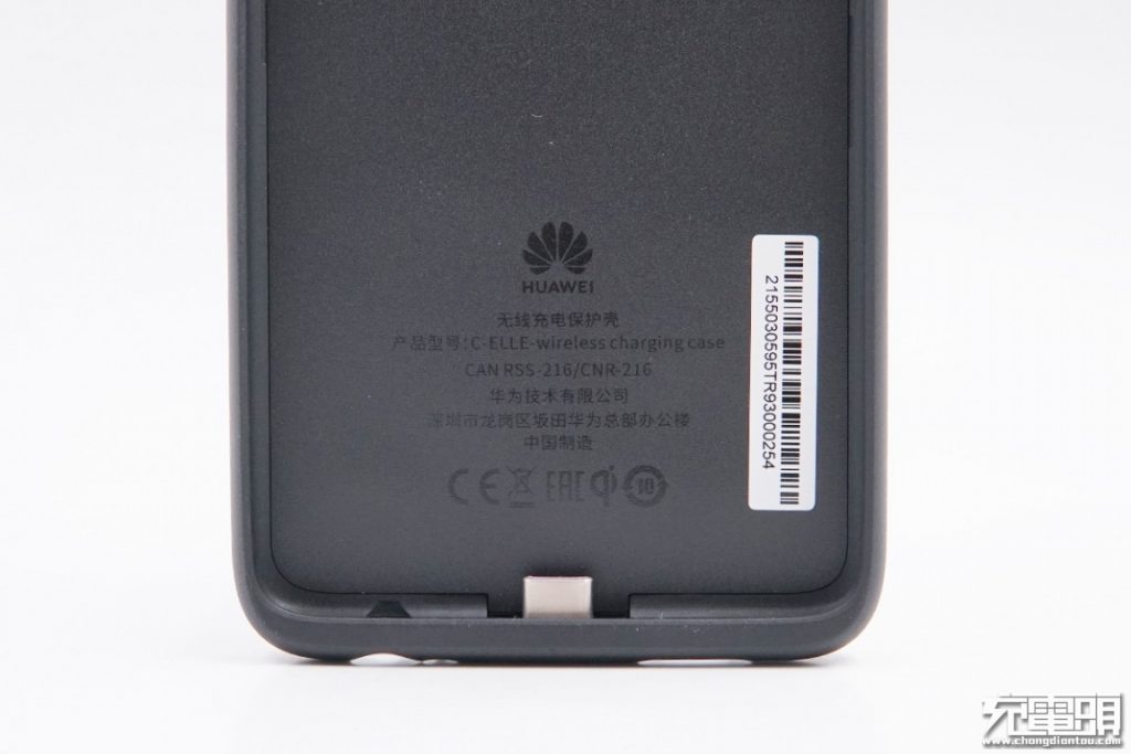

Logo, model name and specifications are printed on the inside of the protective case. Model: C-ELLE-wireless charging case.

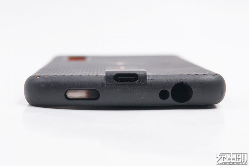

HUAWEI P30 Wireless Charging Case Teardown Review-Chargerlab

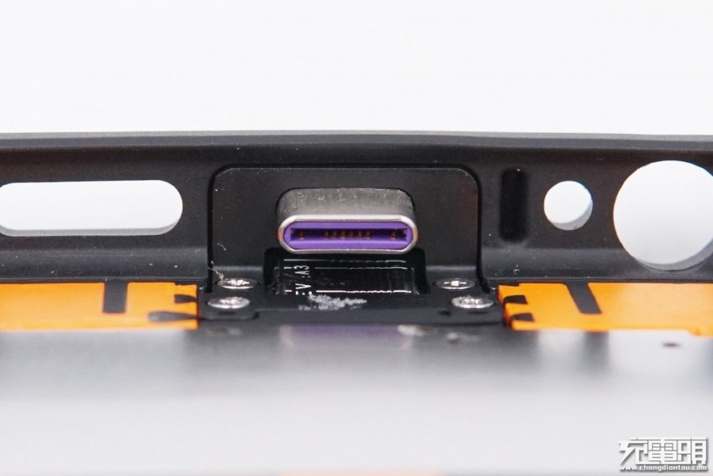

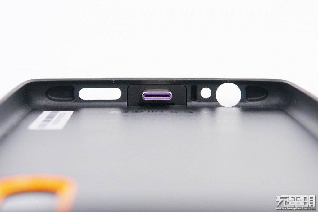

There is a USB-C connector at the bottom for connecting to the Huawei's P30.
The USB-C connector.

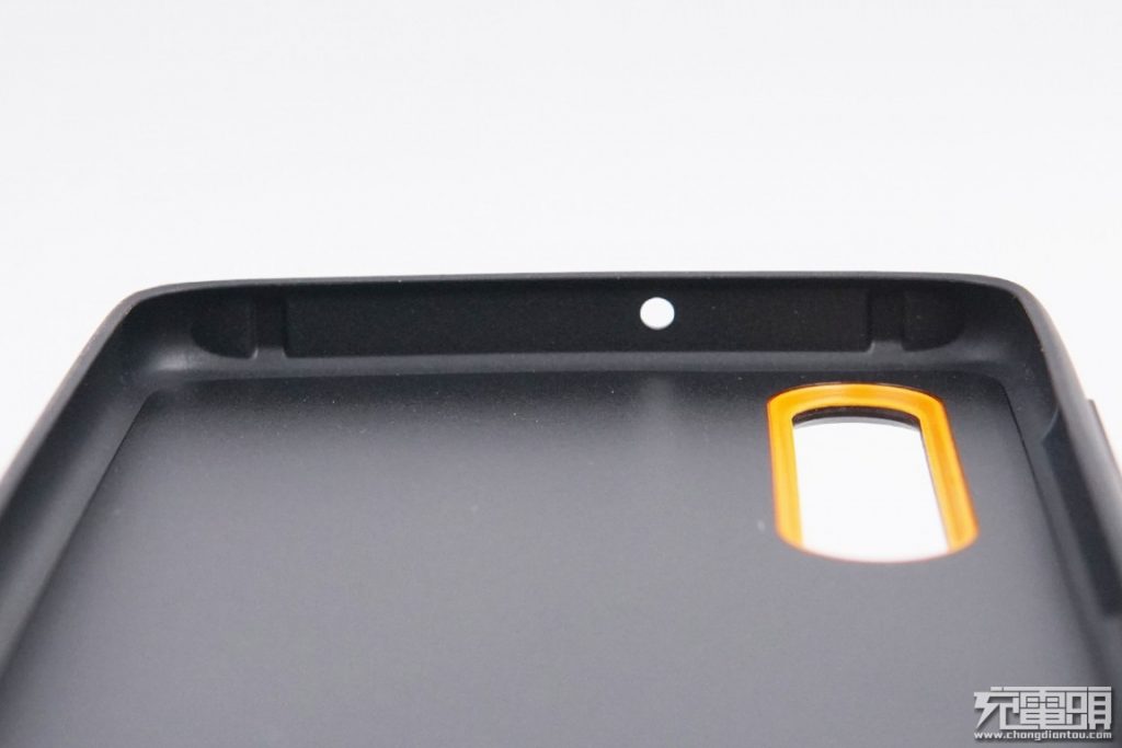

A hole on the top.
Openings for speaker, microphone and headphone.

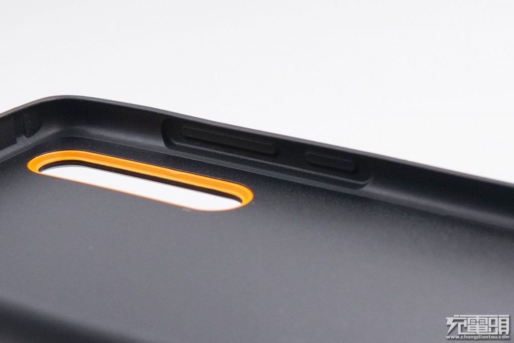

The side.
Close-up of the side buttons.

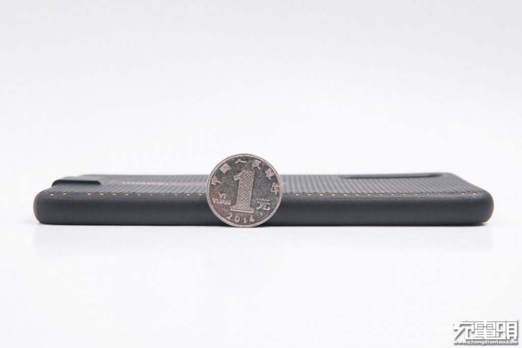

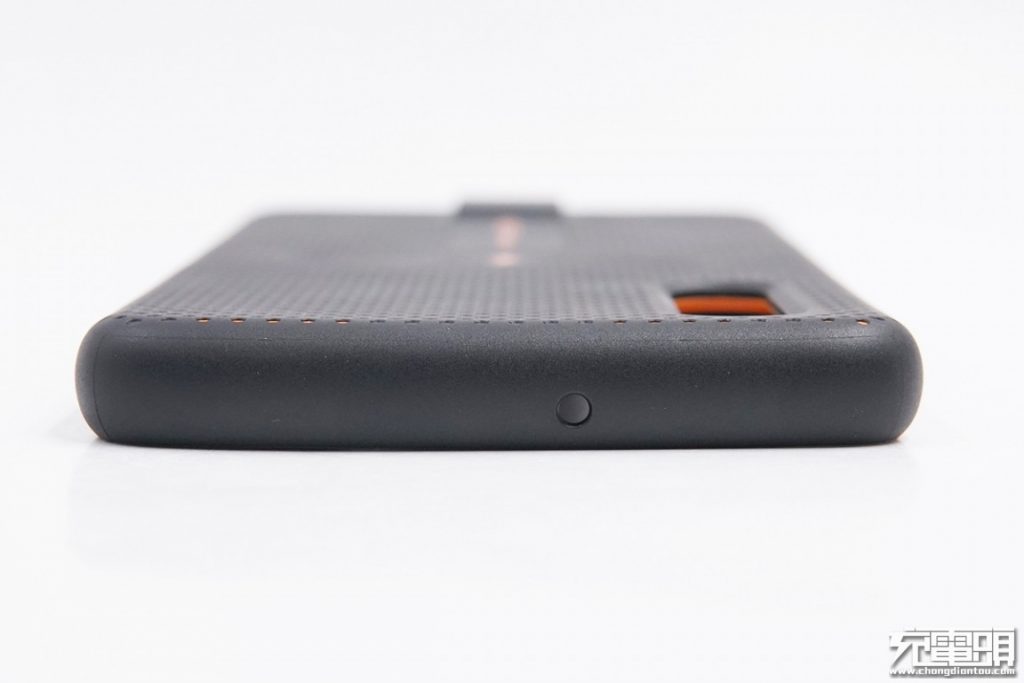

The thickness is only one-third of a 1 Yuan RMB coin. The USB-C port area has a slight bump.

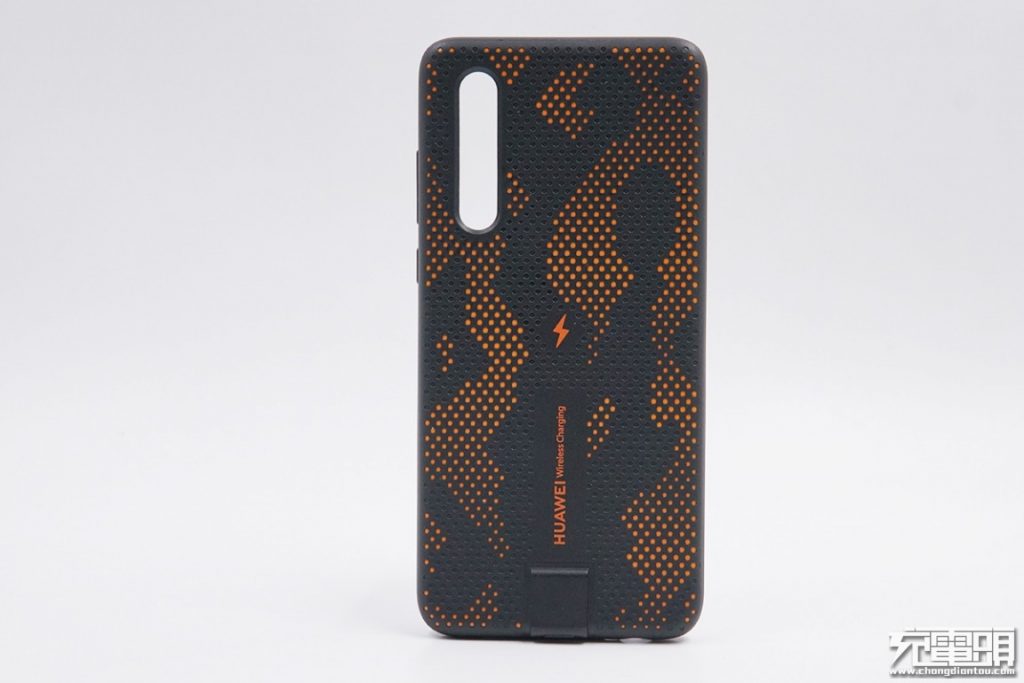

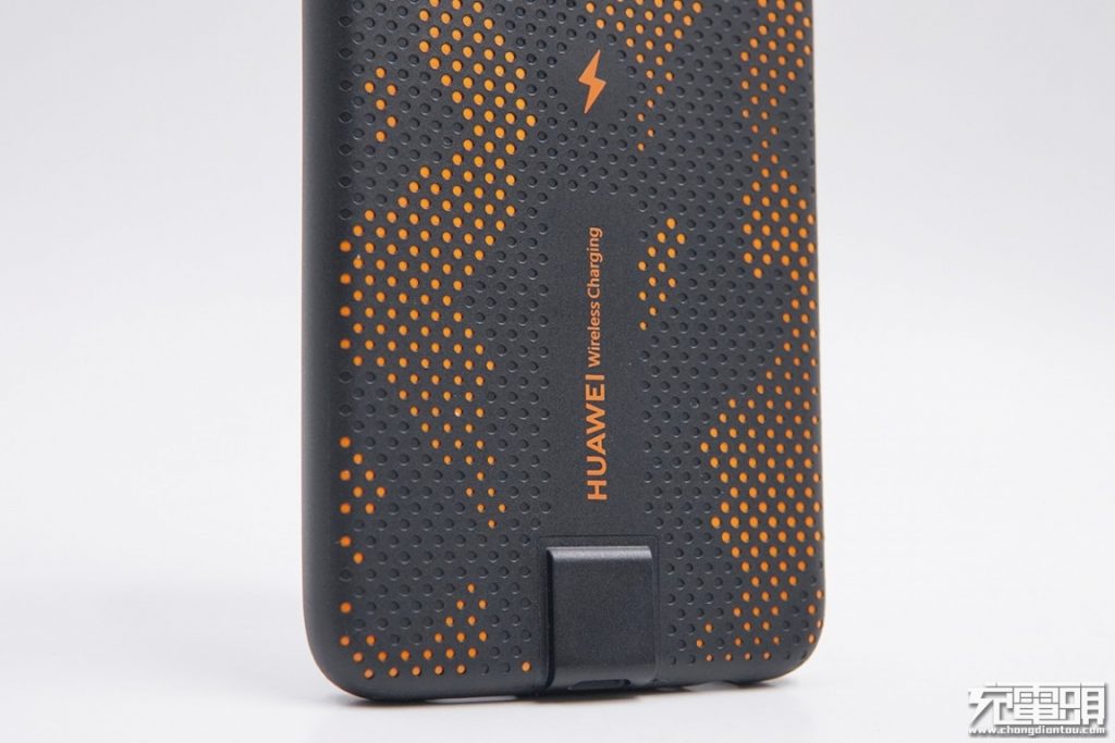

HUAWEI logo and Wireless Charging lettering on the back. It supports 10W wireless fast charging.

Close-up of the matte finish on the inside.

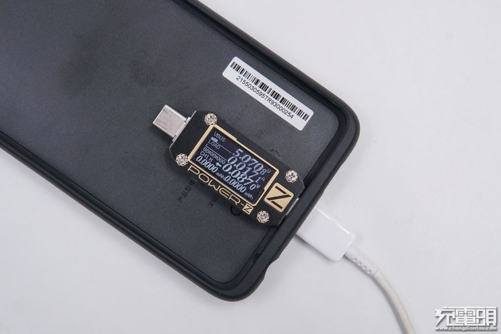

In addition to wireless charging and receiving, the case also supports wired charging through its USB-C port.

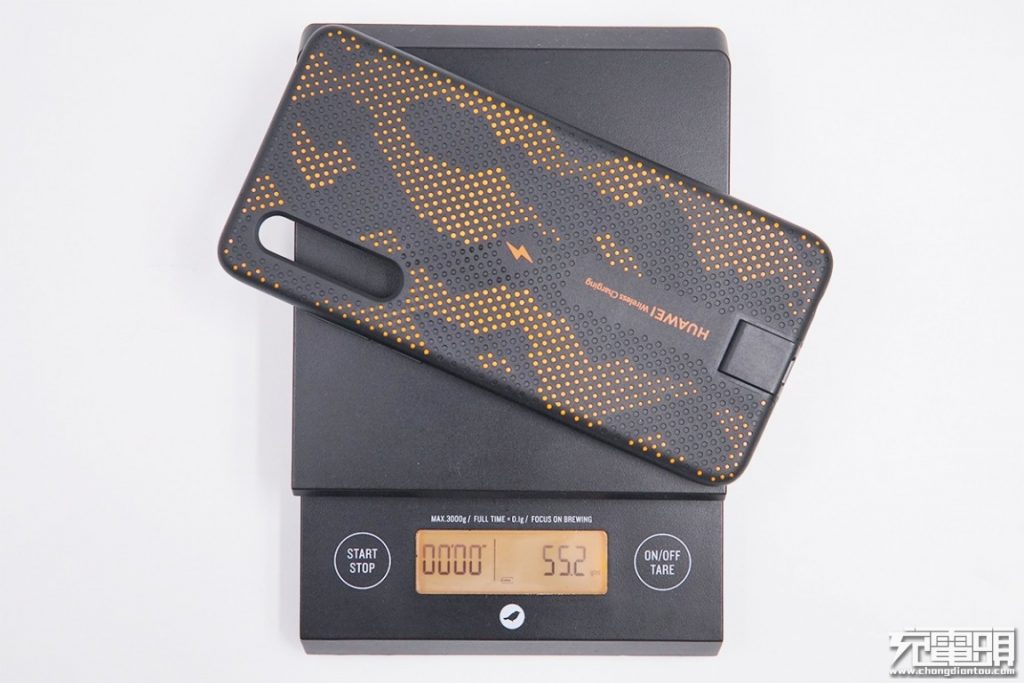

The case weighs 55.2g (1.95oz).

The product also supports wired charging.

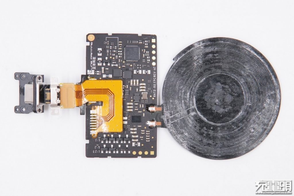

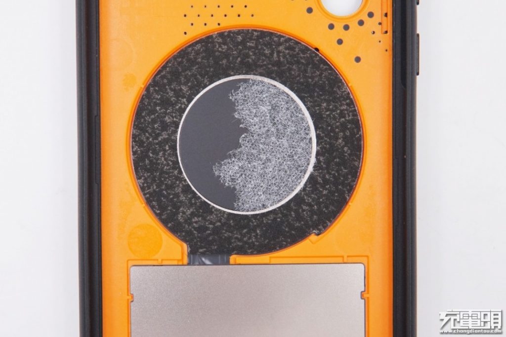

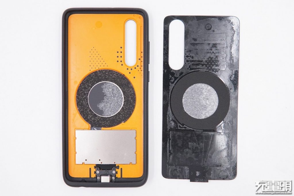

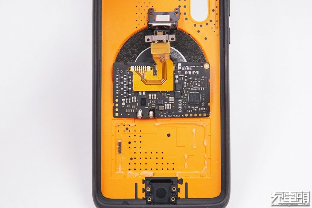

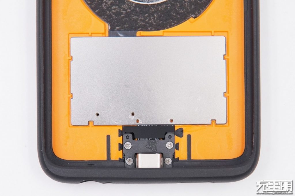

Pilling off the film on the back reveals the coil core, wireless charging receiving circuit board and charging port.
On the top is the wireless charging receiving coil, and the receiving circuit board below has a metal plate to dissipate heat.
The circuit board is connected to the charging receiving coil above, and the charging input and output ports below.
The wireless charging receiving coil is connected to the receiving board via an FPC.

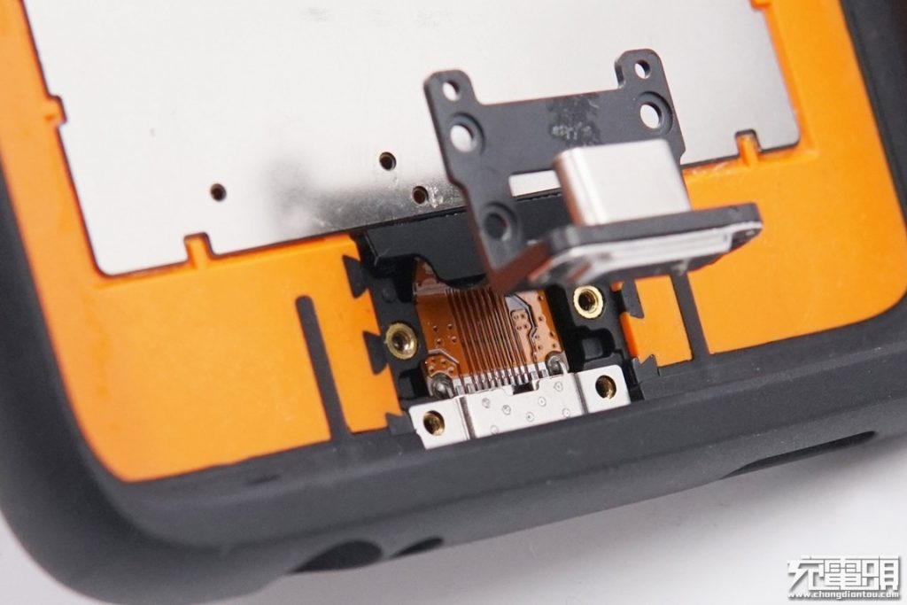

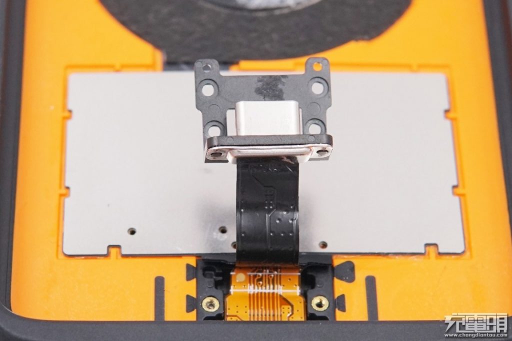

The purple USB-C connector is fixed by screws.

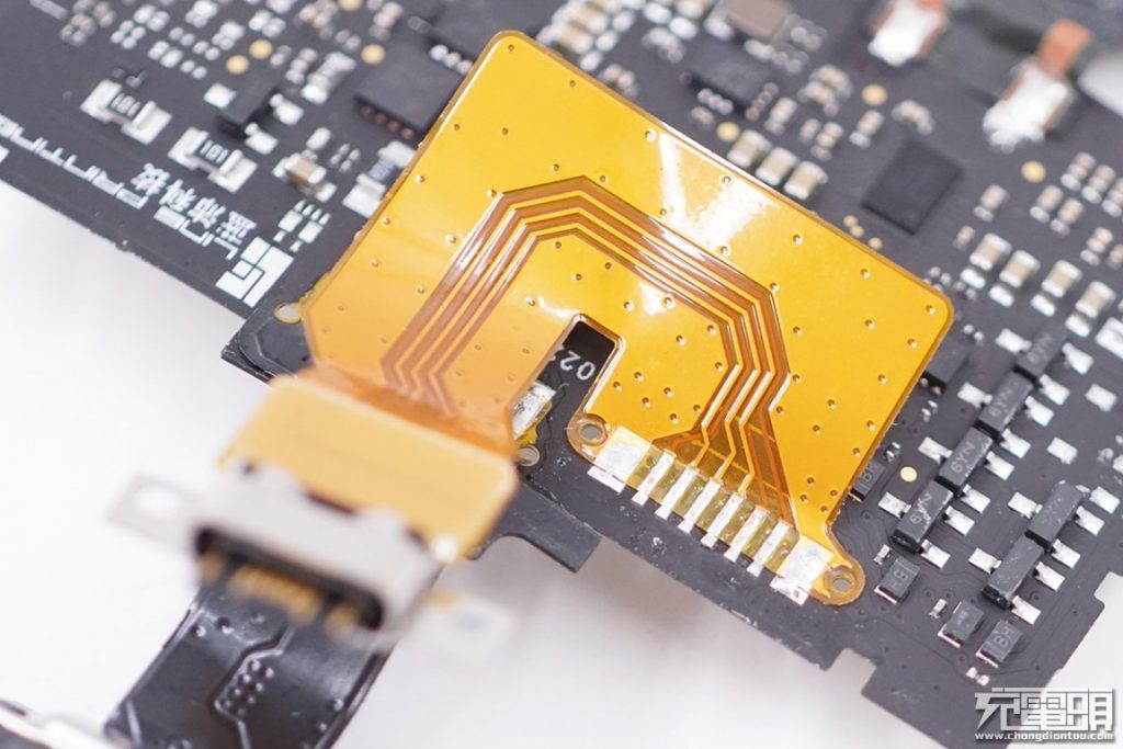

Unscrew the screws and take out the connector. The plug is connected via an FPC.
Close-up of the FPC.

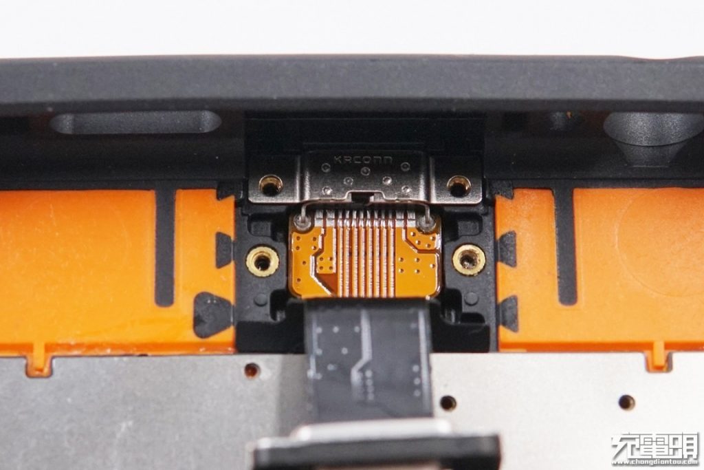

The charging socket of the case is directly inserted into the protective case when wired charging is used.
There is a fixture to secure the position of the connector.

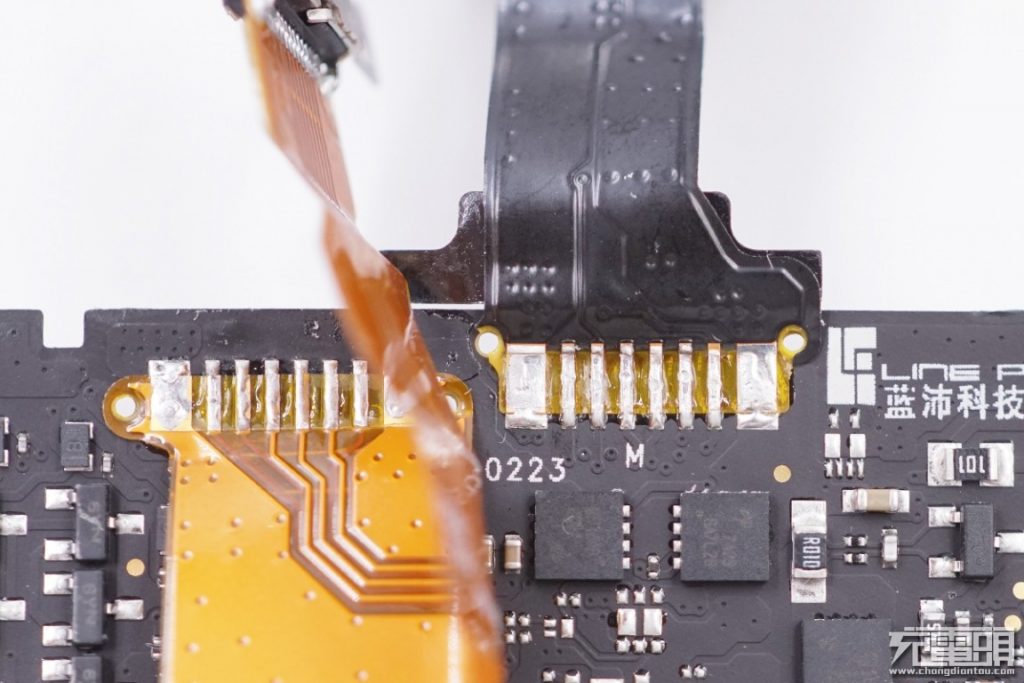

The charging input and output use separate FPCs.
The wireless charging receiving PCB uses FPC cable, uses a metal plate on the back with single-sided printing.

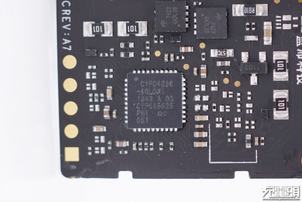

The front side of the wireless charging receiving board is divided into a wireless charging receiving part and an input switching part.

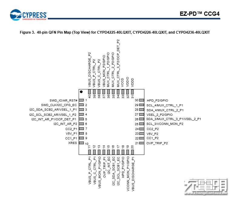

CYPRESS CYPD4236 CCG4 PD controller, which provides two complete USB Type-C and PD interface control, suitable for notebooks, power adapters, and hubs.
CYPRESS CYPD4236

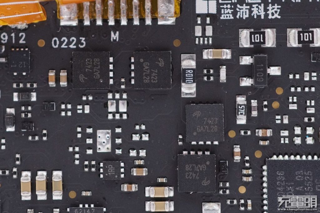

Four AON7423s are used for power switching and anti-backfilling.

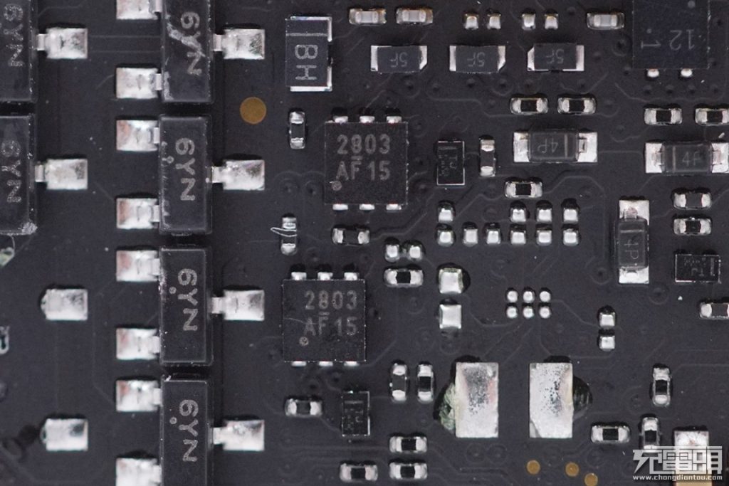

AOS AON2803, MOS transistor.

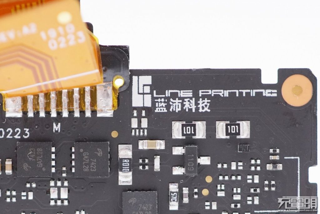

Manufactured by Shanghai Lineprinting Materials Co., Ltd.
