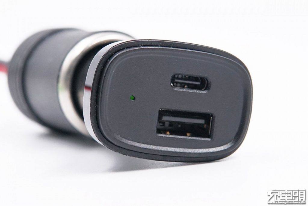

A small LED indicator on top of the USB-A and USB-C ports.
Size comparison with an RMB 1 yuan coin.
The LED indicator emits green light when the car charger is turned on.

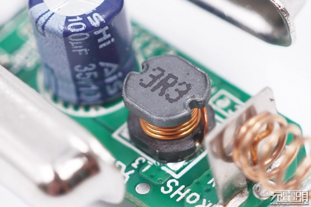

The input filter electrolytic capacitor comes from AiSHi, 35V 10μF.
3R3 filter inductor.
